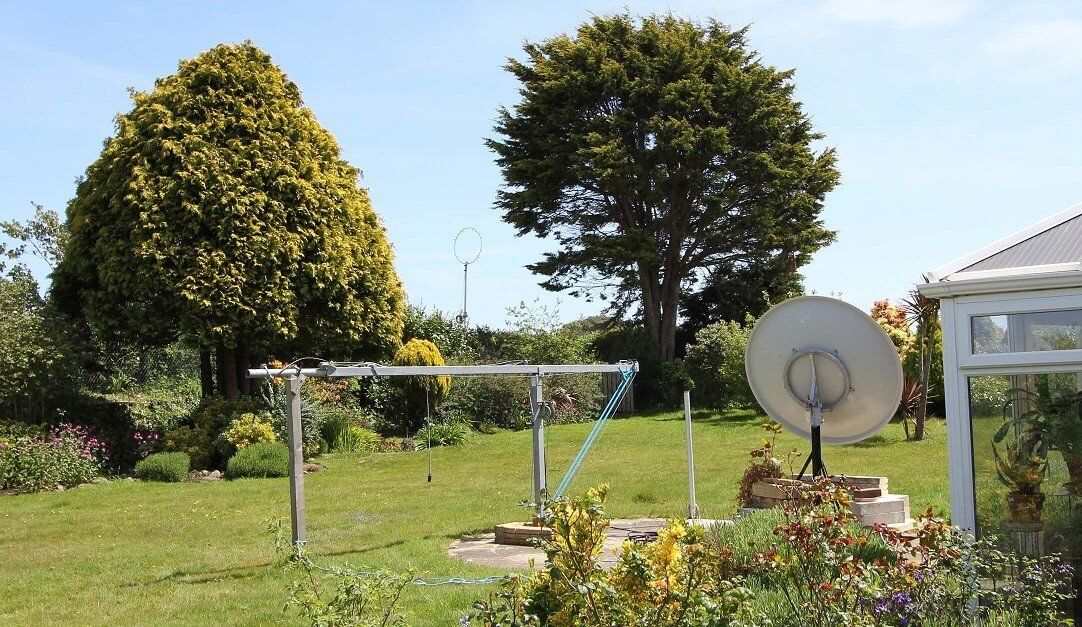

My Station
Here's a link to G4ELI's station:
  • Antenna
  • LNB - POTY from Sigi DG9BFC
  • SDR transceiver
  • GPDO
  • Gallery

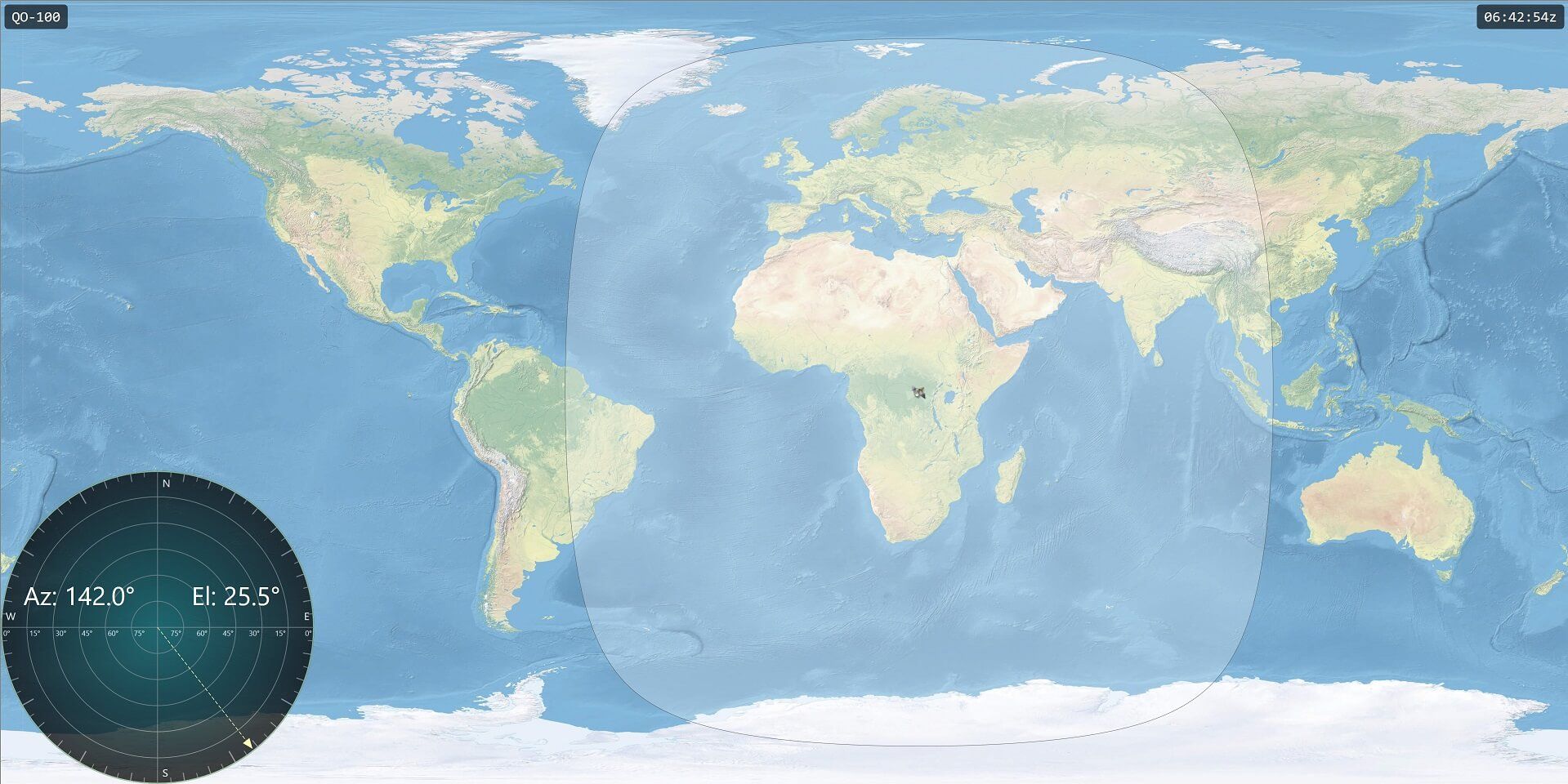

Footprint
Here's the Es'Hail 2 footprint. Use the Satellite option in SDR Console to display:
  • Footprint,
  • Azimuth, Elevation,
  • Distance,
  • Path loss.
There is a very small amount of Doppler, even for a geostationary satellite, but not enough to worry about. Here you see the footprint.

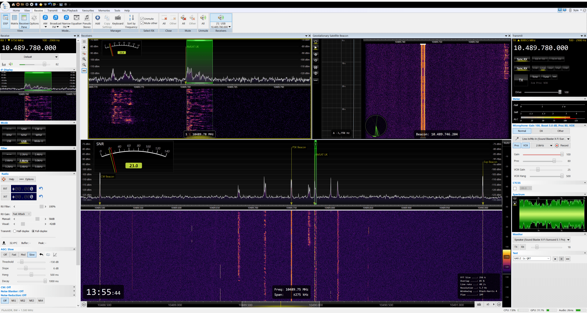

Screenshot
Below is a screenshot of the console in action, on the right the Transmit pane shows:
  • TX frequency synchronised with RX, both show 10489.700 MHz.
  • TX mode synchronised with RX, both show USB.
  • Mic in selected, audio level shown in the Spectrum window.

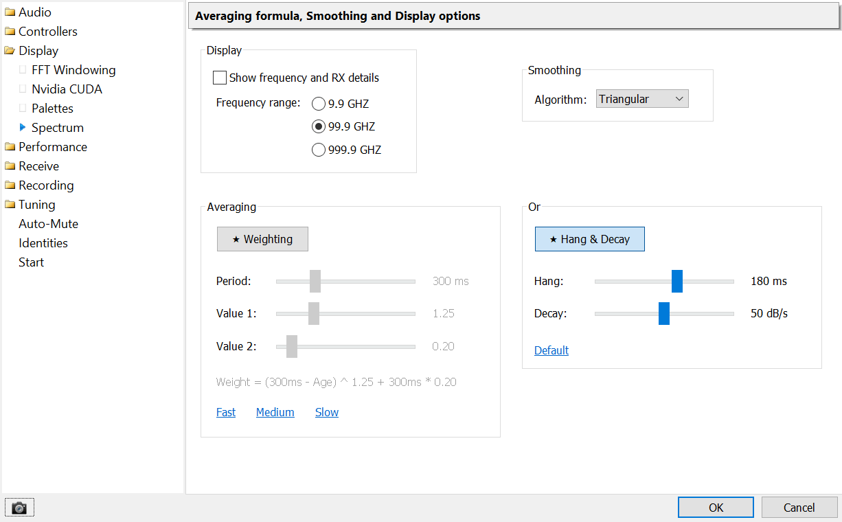

Display 10 GHz
To display a frequency of 10 GHz or higher open the Program Options and navigate to Display, Spectrum. Select a frequency range of 99.9 GHz, then press [OK].

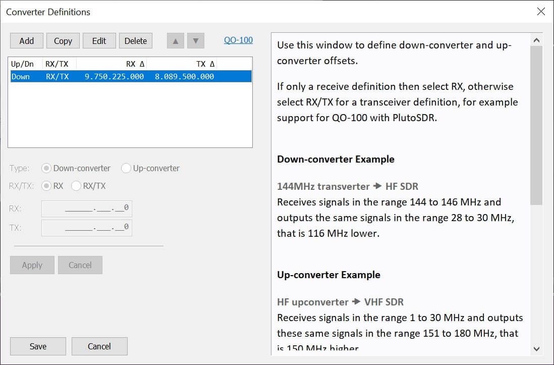

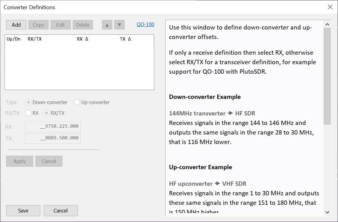

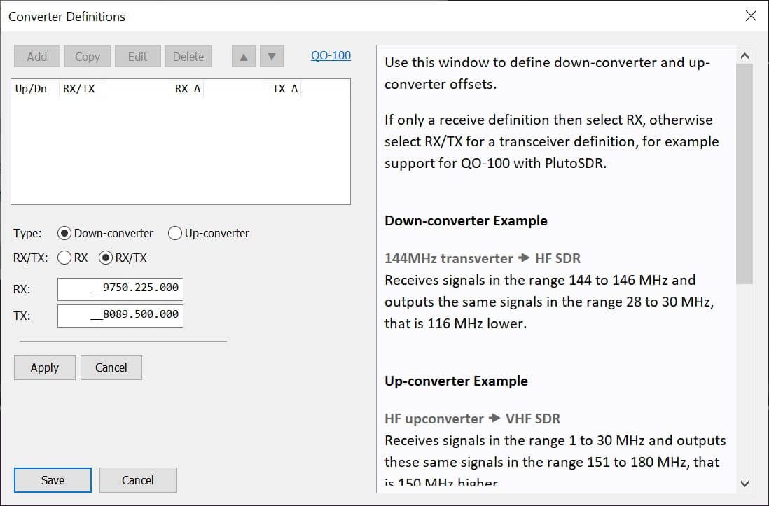

Converter Definition
Note: In version 3.0.16 the old converter definition + TX offset has been replaced with a RX/TX converter with full transceiver support, a big improvement over previous versions.
In the Radio Definitions window check Converter selection, then press Edit.
In the Converter Definitions window click the QO-100 link (top center) to automatically enter the common settings for a QO-100 down-converter. The receive downconverter is 9,750.225 MHz, the transmit is 8089.5 MHz.

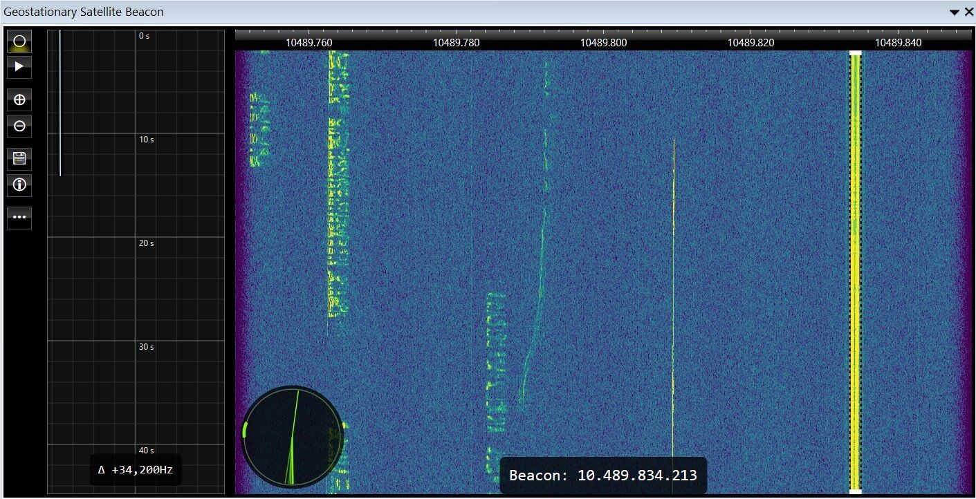

Telemetry Beacon
Enable the Geostationary Beacon option: Ribbon Bar, View, More Options..., check [X] Geostationary beacon.
Note: the idea for synchronising with the telemetry beacon comes from Moe Wheatley (AE4JY) in his AO-40 Telemetry Decoder Project. Moe's code explains how the data beacon works as the QO-100 beacon is the same as that in AO-40 (RIP). The implementation here was coded from the ground up to ensure it is as efficient as possible, every saved cycle helps!
⚠️ February 14th 2020: Telemetry beacon frequency changed from 10,489.800 to 10,489.750 MHz.
The telemetry beacon frequency is 10.489.750.000 Hz, or 10,489.750 MHz. The beacon transmits BPSK, simple BPSK decoding software can determine the offset from the nominal center frequency, so compensation for an un-modified consumer LNB is possible.
Follow these steps:
  • Start the display - press ○
  • Select the beacon by clicking in the center of the beacon trace, the window on the left will display the offset, use ⊕ and ⊝ to adjust the waterfall zoom level
  • Enable offset compensation - press ▶
Use the Save 💾 option to download the offset data to a CSV file, this file can be viewed with programs such as Excel.

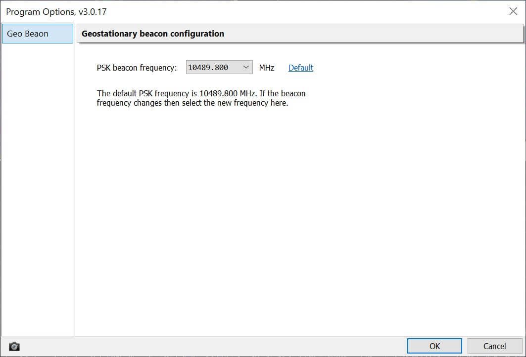

In version 3.0.15 the beacon frequency is user-selectable should the frequency change in the future. An option button ••• has been added to the display, this displays the options window below where the beacon frequency is selected.

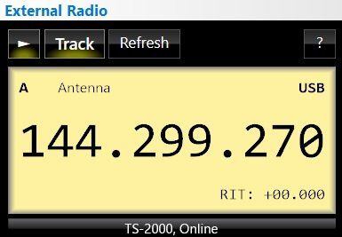

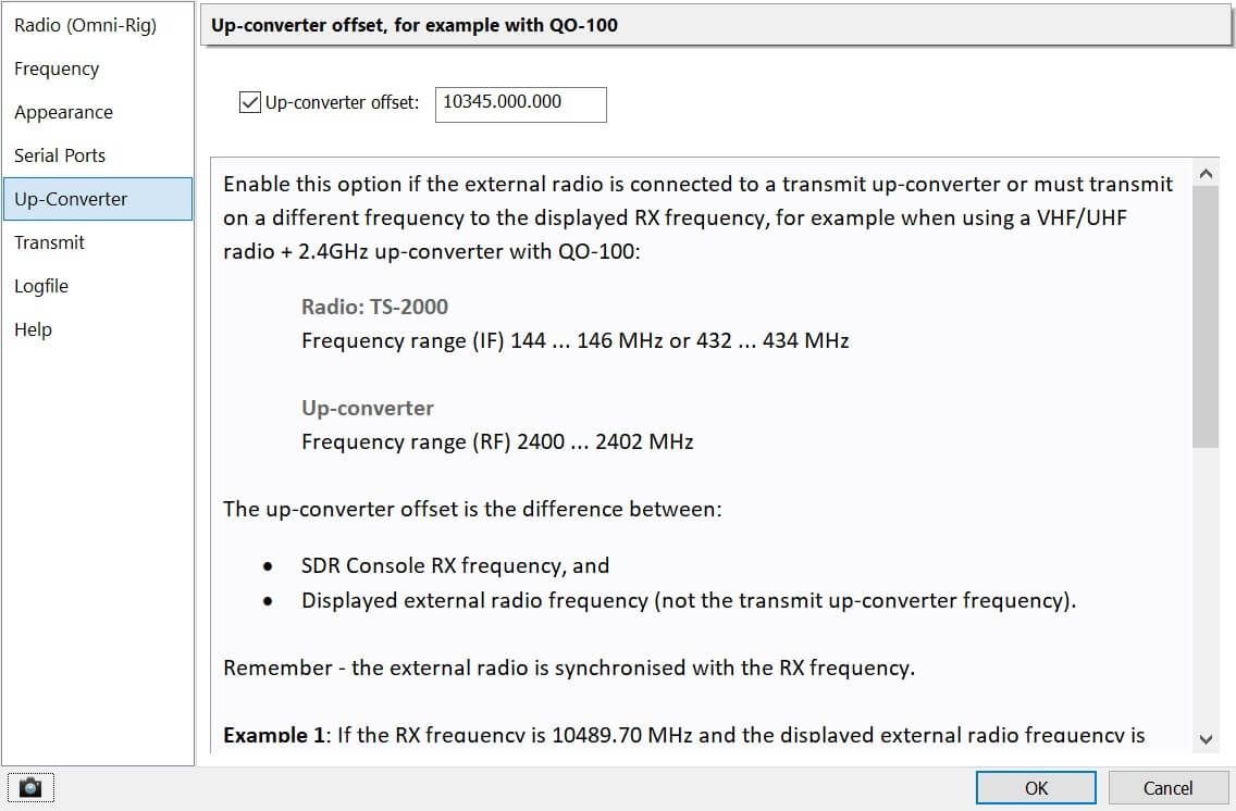

External Radio
In 3.0.17 and above you can synchronise SDR Console with an external radio used for transmit. The External Radio page is here [link].
Enable this option if the external radio is connected to a transmit up-converter or must transmit on a different frequency to the displayed RX frequency, for example when using a VHF/UHF radio + 2.4GHz up-converter with QO-100:
  • Radio: TS-2000
    Frequency range (IF) 144 ... 146 MHz or 432 ... 434 MHz
  • Up-converter
    Frequency range (RF) 2400 ... 2402 MHz
The up-converter offset is the difference between:
  • SDR Console RX frequency, and
  • Displayed external radio frequency (not the transmit up-converter frequency).
Remember - the external radio is synchronised with the RX frequency.
Example 1
If the RX frequency is 10489.70 MHz and the displayed external radio frequency is 144.70 MHz then the up-converter frequency is:
10489.70 - (RX Frequency)
  144.70 (External radio)
10345.00 MHz
So you enter 10345.000.000 as the up-converter offset.
Example 2
If the RX frequency is 10489.60 MHz and the displayed external radio frequency is 432.60 MHz then the up-converter frequency is:
10489.60 - (RX Frequency)
  432.60 (External radio)
10057.00 MHz
So you enter 10057.000.000 as the up-converter offset.
Console Settings
