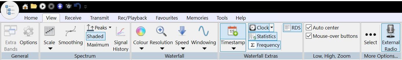

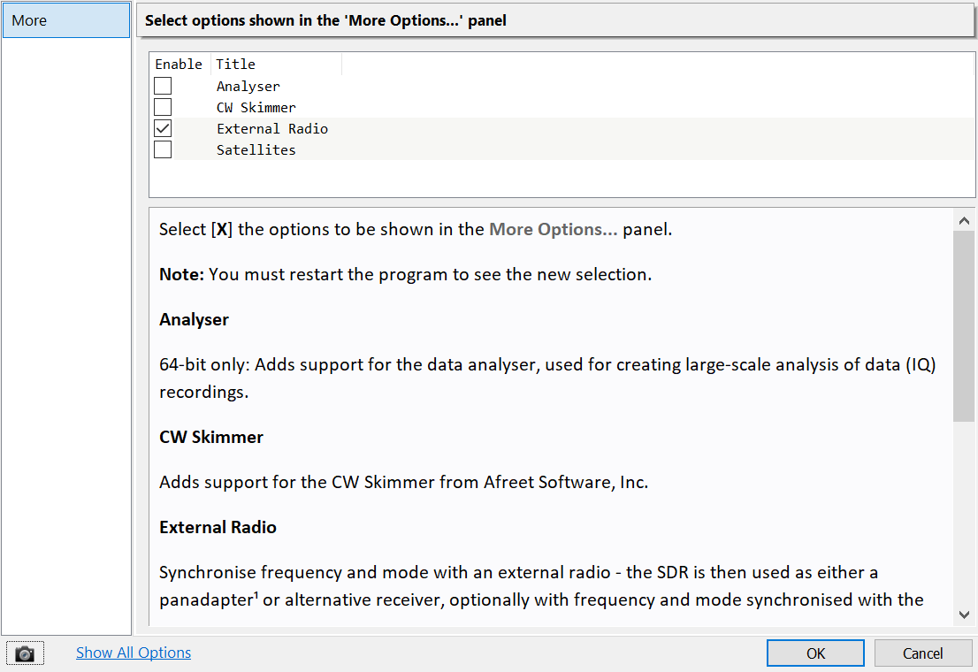

Enable
Before you can use this option you must enable it. From the ribbon bar's View pane select More Options... and enable External Radio.

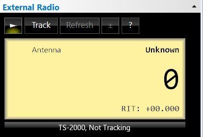

After restarting the console the External Radio display is added to the Receive DSP panel.

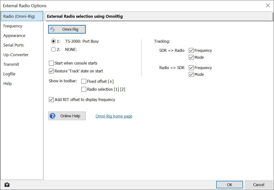

Display the options by pressing the ? button in the main display.
Radio (Omni-Rig)
Omni-Rig can connect to two radios at the same time, although you would very rarely use this option it is supported here.
  • Start the external radio window when the console starts.
  • Restore tracking state when starting the radio.
In this window you also add options to the toolbar if required:
  • Show +/- offset (RIT).
  • Rig selection (1 or 2).

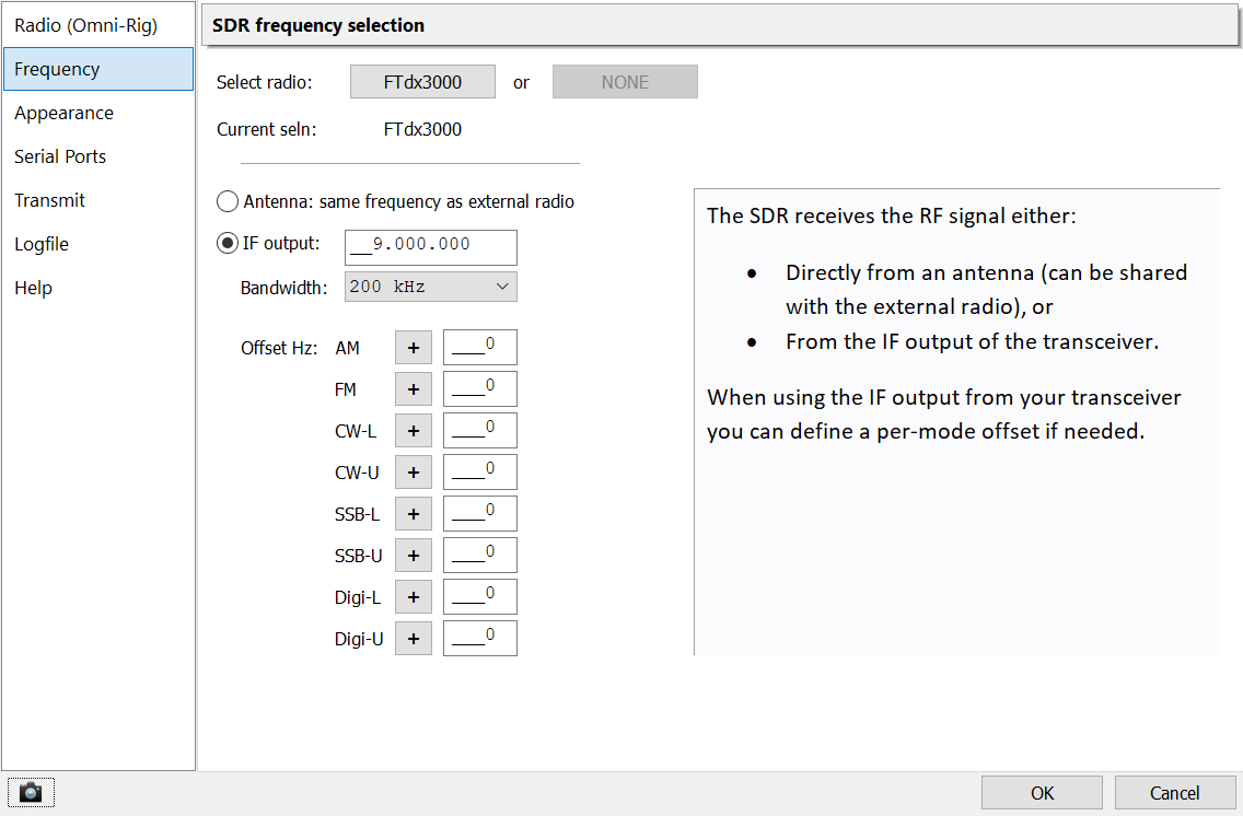

Frequency
The SDR receives the RF signal either:
  • Directly from an antenna (can be shared with the external radio), or
  • From the IF output of the transceiver.
When using the IF output from your transceiver you can define a per-mode offset if needed. This is usually required with Yaesu radios.

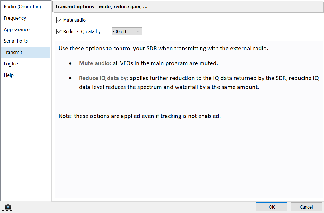

Use these options to control your SDR when transmitting with the external radio.
  • Mute audio: all VFOs in the main program are muted.
  • Reduce IQ data by: applies further reduction to the IQ data returned by the SDR, reducing IQ data level reduces the spectrum and waterfall by the same amount.
Note: these options are applied even if tracking is not enabled.

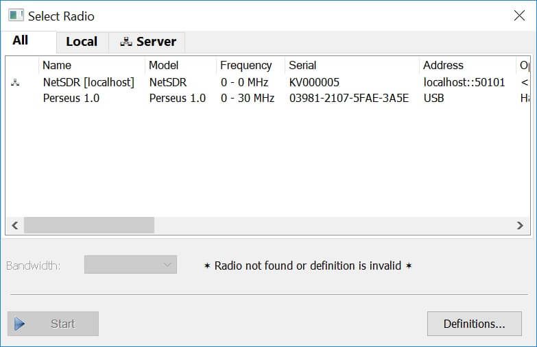

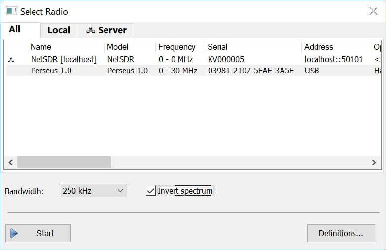

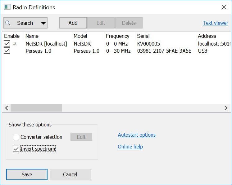

If the spectrum is inverted then follow these steps to enable the Invert Spectrum option.
  1. Open the Select Radio window,
  2. Click Definitions,
  3. In the Radio Definitions window check Invert Spectrum,
  4. Click Save.
When you select the radio now check Invert Spectrum in the Select Radio window.

To configure Omni-Rig you must open the external radio options, to do this press the ? button in the external radio window.
  • Use the Serial Ports page to find the ports on your computer.
  • In OmniRig set the Poll Int. ms (polling interval in milliseconds) to 100 (or lower if supported). If you do not set a low polling interval the response will be sluggish.
  • Check the baud rate selected in OmniRig and the baud rate on your radio are the same. A higher baud rate will give a better response but can return erratic values if set too high.
  • Check the OmniRig website and support groups for your radio to ensure you have the latest OmniRig support files (.ini).
