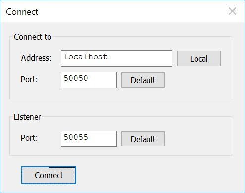

BOOL SDRRepeaterConnectDlg(CWnd* pWndParent)
Displays the connection window (modal dialog), if the connection is successful the console starts streaming the IQ data. Use a unique Listener port for each computer in your network.
