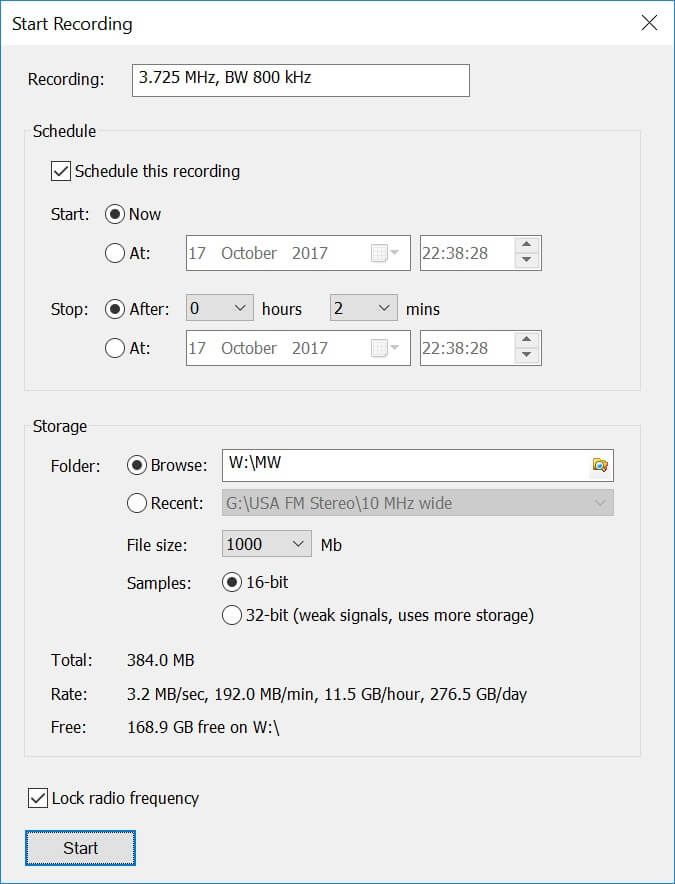

From the Rec/Playback pane in the ribbon bar select Data :: Record, Record, the Start Recording window is displayed.
The options include:
  • Scheduling the recording,
  • Size of each file,
  • Sample size (16-bit is recommended),
  • Lock the radio so it is not accidentally changed while a recording is in progress.

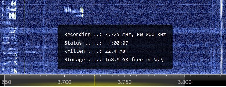

Press Start to start the recording. While a recording is in progress the status is displayed in the waterfall.

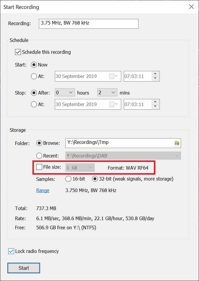

WAV and WAV RF64 formats are supported. WAV only supports files up to 2GB in size whereas WAV RF64 supports an unlimited file size (actually approximately 16 exabytes).
If the file size is not selected or is selected with a value greater than 2GB then WAV RF64 is used, otherwise WAV is used.

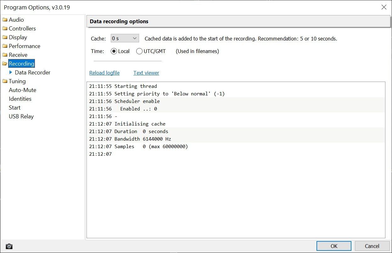

Cache
Enable a cache of up to 30 seconds by selecting Recording, Data Recorder from the program options.
Adding a cache results in more memory used by the program as the cache is stored in program memory.

This format is based on WAV with a maximum file size of approximately 16 exabytes (1 million terabytes). SDR Console supports recording and playback with the WAV RF64 format, however some popular IQ analysis/playback programs do not support this format. If a program cannot play back a WAV RF64 then you must create the recording using the WAV format. A typical error message when WAV RF64 is not supported is 'Invalid RIFF Header'.
Selecting
When you start a Data (IQ) Recording the file format is shown when you select the individual file size.

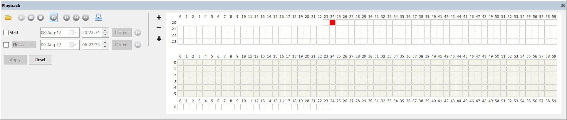

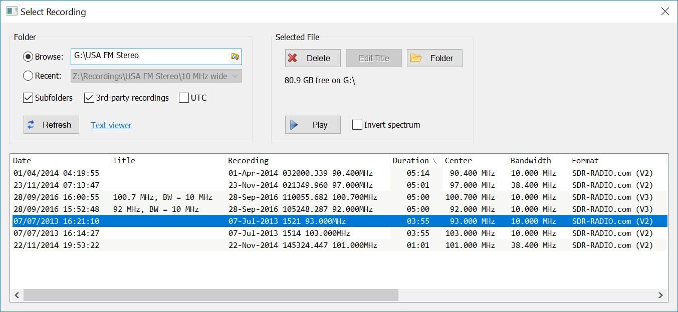

From the Rec/Playback pane in the ribbon bar select Data :: Record, Open. The Select Recording window is displayed.
Select a recording, then press Play. To aid navigation of the selected recording select Navigator from the Rec/Playback pane in the ribbon bar.
