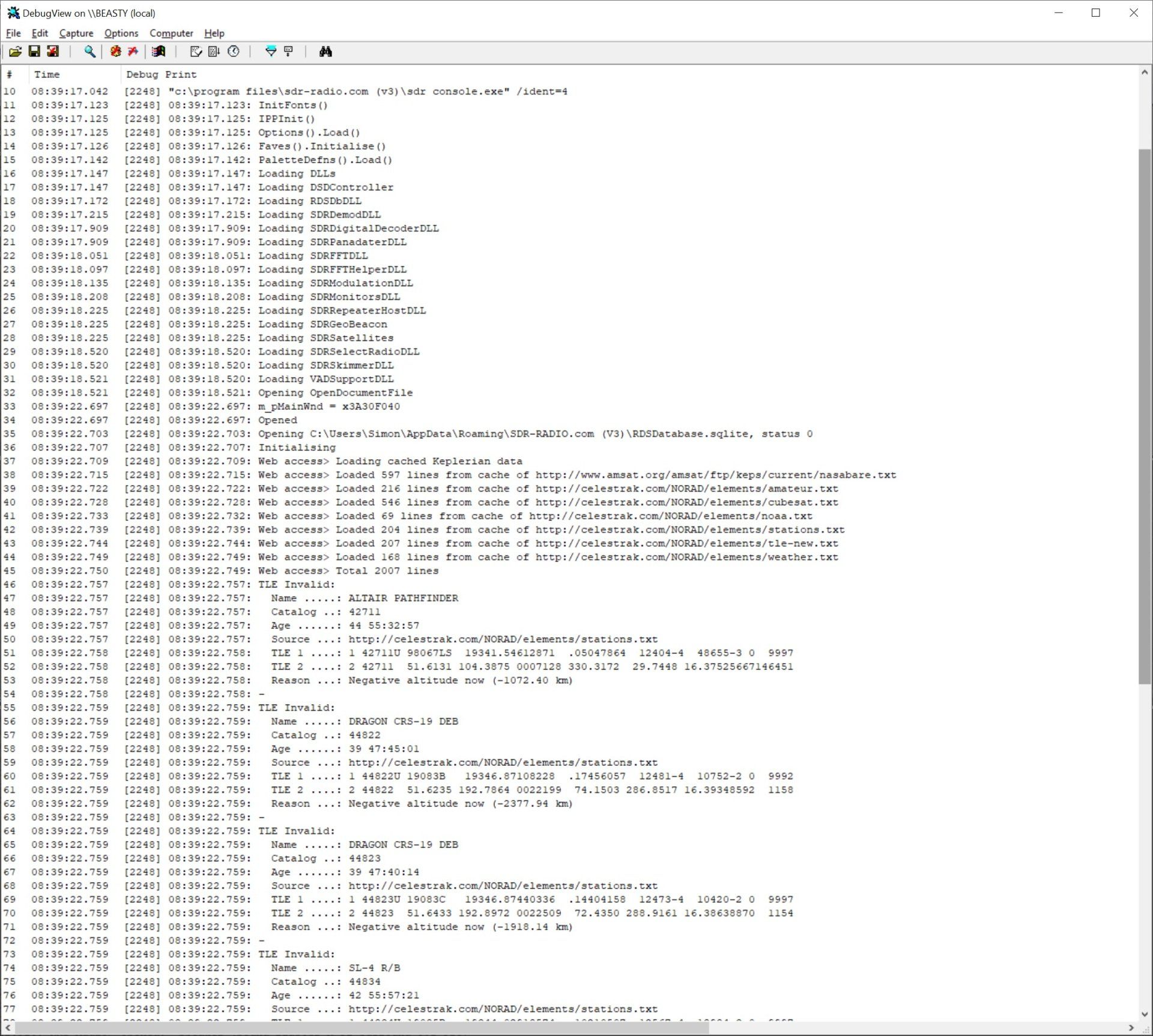

DebugView is an application that lets you monitor debug output on your local system [link].
After you download and install DebugView all system level diagnostic messages are displayed, not just from SDR Console but from any program running on your computer.
Sample output generated when SDR Console starts is shown below.
- Save the output as a text file from the File menu.

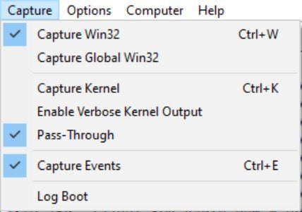

- You must enable Capture Win32 from the Capture menu.
