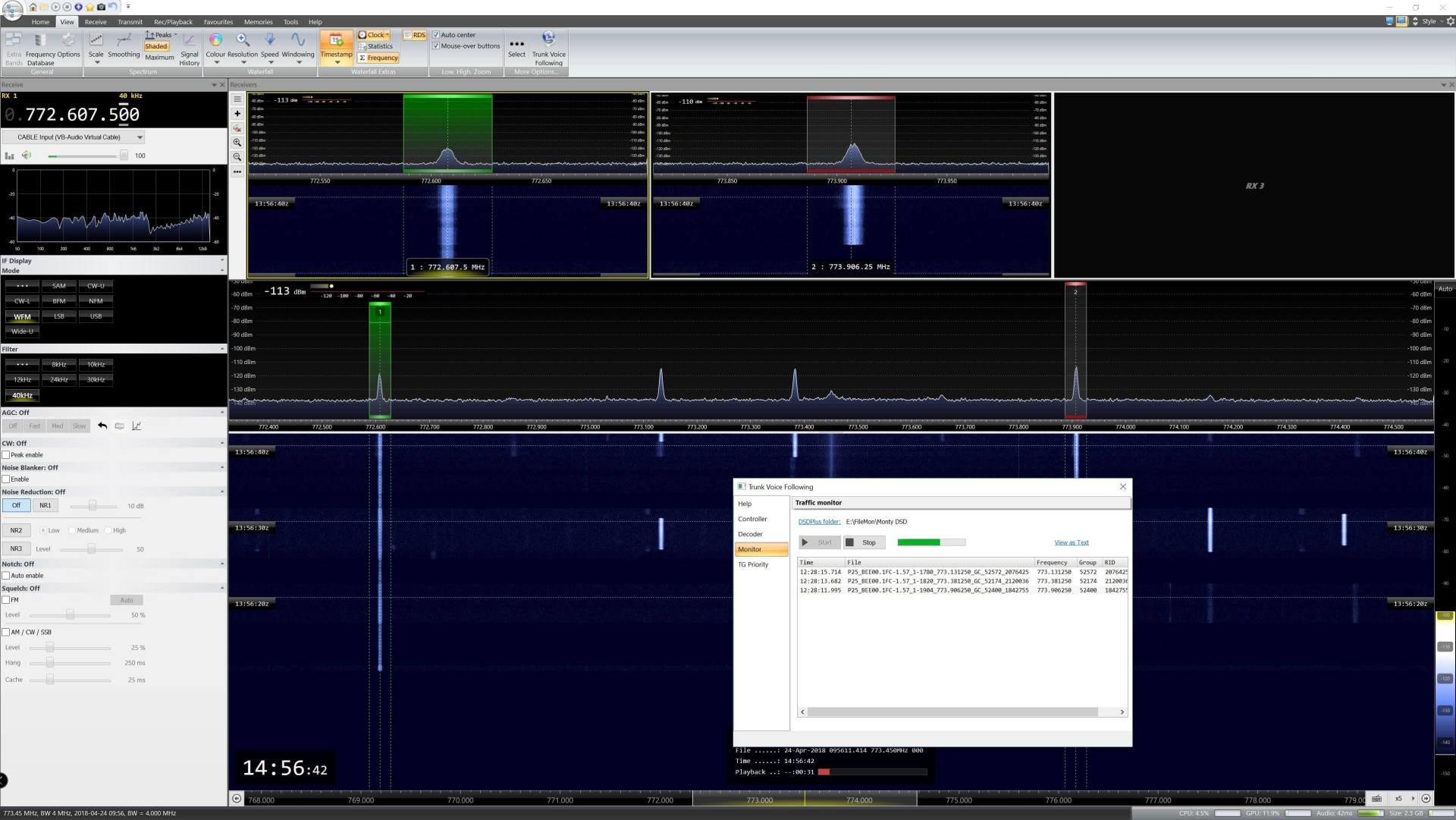

The implementation in SDR Console supports Trunk Tracking and Voice Following with a single wide-band radio such as the Airspy R2 or SDRplay RSP1A. Receiver 1 (RX1) is tuned to the control frequency, up to five receivers (RX 2 ... RX6) are tuned to the voice channels.
This implementation uses DSDPlus for the controller, monitors the output (*.traffic files) and tunes the voice receivers which interface with 3rd-party decoding software via a virtual audio cable (VAC).
Note: You may need a DSDPlus Fast Lane release for controller support.
From the ribbon bar, View pane, More Options panel press Select
then enable Trunk Voice Following. After a restart a new entry is shown in the More Options panel.

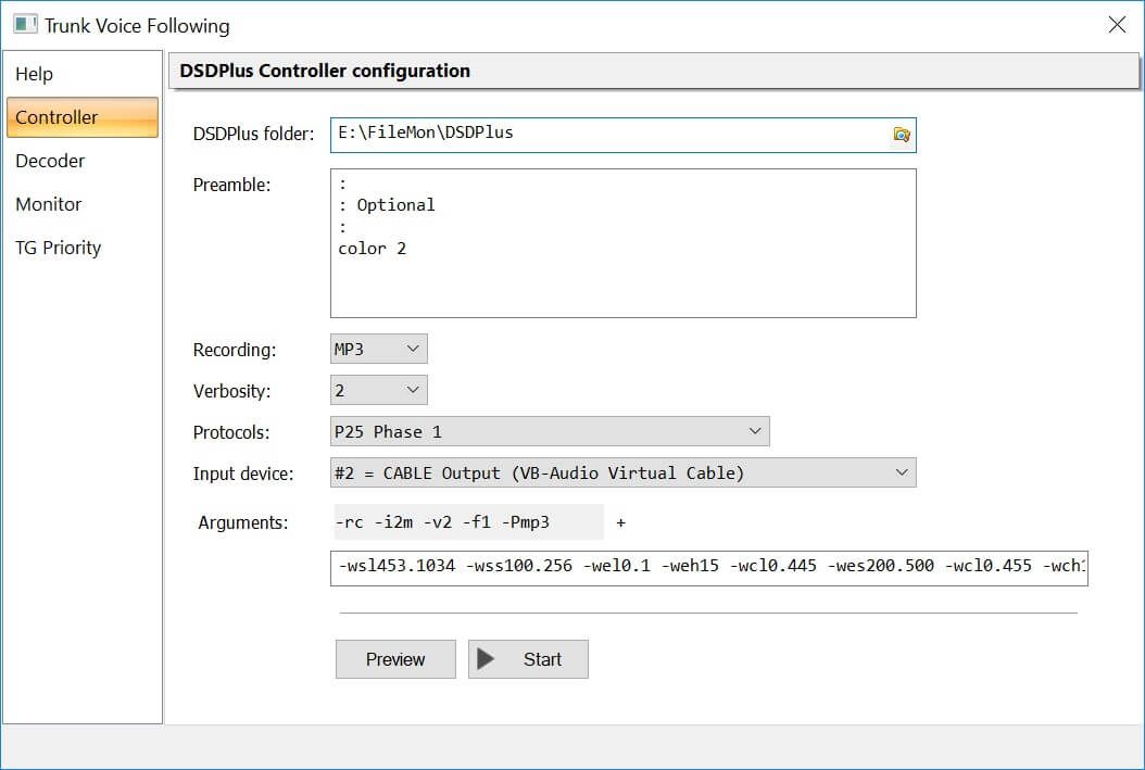

Controller
Use DSDPlus to monitor the controller channel. For your convenience you can configure and start DSDPlus here. Console receiver RX1 is reserved for the controller. All DSDPlus options are described in the file DSDPlus.txt in the docs subfolder of the DSDPlus installation.
- DSDPlus folder - select the folder containing the DSDPlus executable.
- Preamble - DOS commands which are processed before DSDPlus is started.
- Recording - Create per-call WAV or MP3 files (default is none).
- Verbosity - Controls the amount of information written to the log file.
- Protocols - Either all protocols or just a single protocol. If a single protocol is selected the control has less work to perform when a new signal is detected.
- Input device - the same virtual audio cable selected for the output of the console's receiver 1 (RX1).
- Arguments - see DSDPlus.txt in the docs folder of your DSDPlus installation for a full list of available arguments, the defaults should be acceptable for most users.
Press Preview to view the .bat file which runs when you press Start. For example:
:: Start in the DSDPlus folder:CHDIR /D "E:\Utilities\DSDPlus":: Optional:color 2DSDPlus.exe -rc -i2m -v2 -f1 -Pmp3 -wsl453.1034 -wss100.256 -wel0.1 -weh15 -wcl0.445 -wes200.500 -wcl0.455 -wch15 >>CC.log -_1 -E -e -tpause

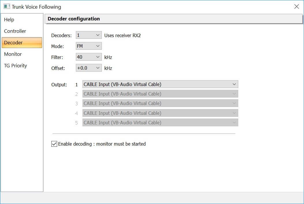

Decoder
In the Decoder page configure the Console receivers which send the output via a virtual audio cable to your decoder, for example Dgo2SIGNALS from go2DECODE or DSDPlus. The receiver frequencies are set by the monitor (below). Receivers RX2 ... are reserved for the decoders. Do not change the receiver options, they are updated when the decoder frequency changes.
- Maximum simultaneous decoders.
- Demodulation mode, for DSDPlus use FM.
- Filter - usually 40kHz but can be reduced if needed.
- Offset - required if your receiver is not calibrated against a known reference source.
- Output - a VAC not is use for the controller (above) or other programs.
Decoding must be enabled!

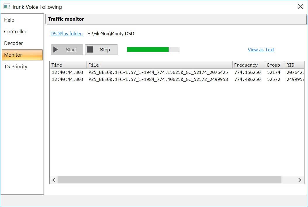

Monitor
Monitors the traffic files created by the DSDPlus controller:
- Parses the file names,
- Extracts the frequency, talk group and Radio ID,
- Assigns the frequencies to the decoders.
The monitor must be started, otherwise there will be no decoding!

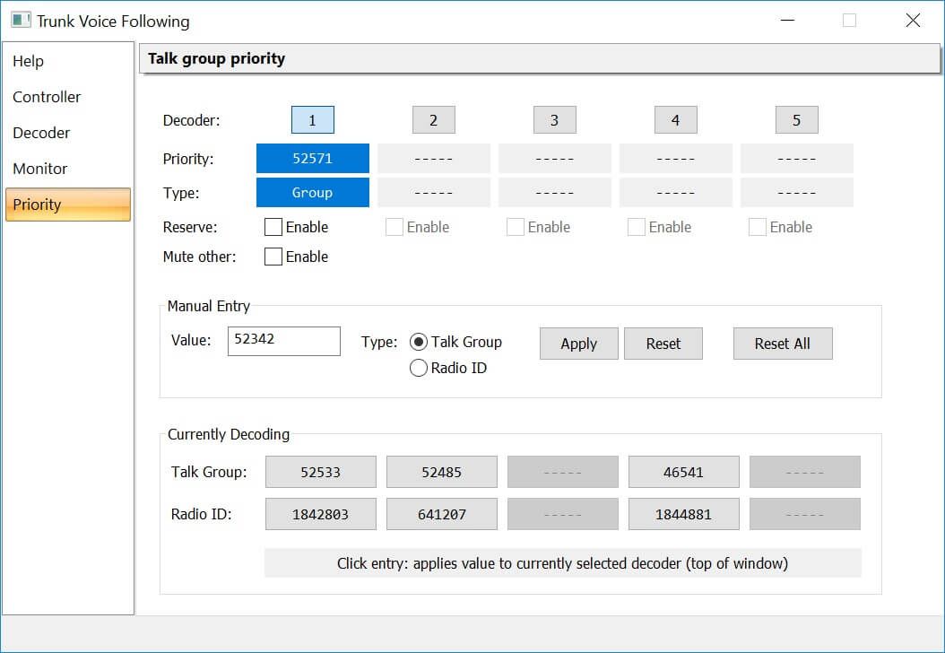

Talk Group Priority
If a talk group is selected then it will take priority in decoder 1. If decoder 1 is running on another talk group / frequency it will be switched to the priority talk group's frequency when the talk group is active.
- Select the decoder to be updated.
- Either:
- Enter a Group / Radio ID, or
- Select a 'Currently Decoding' value.
- Check Reserve to only decode transmissions for the selected ID.
- Decoder 1 only - Mute Other will mute all other decoders when decoder 1 is active.
