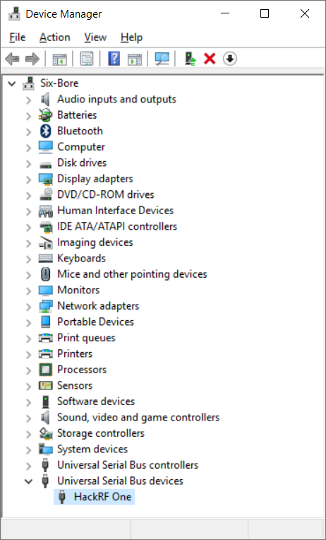

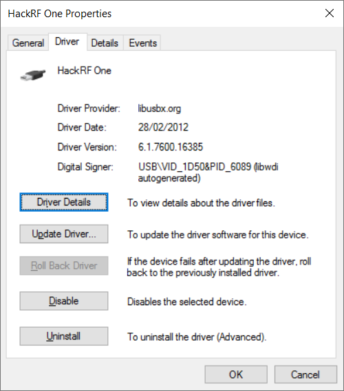

On Windows 10 must use Zadig
to install the correct driver, WinUSB (v6.x.xxxx.xxxxx). Below is a Device Manager screenshot with the hackRF correctly configured.
