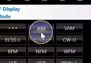

The area of the monitor occupied by SDR Console is recorded, not SDR Console itself. So if you start an application which obscures SDR Console then this application will be included in the recording. Floating panes are only recorded if they are floating over the main Console window.

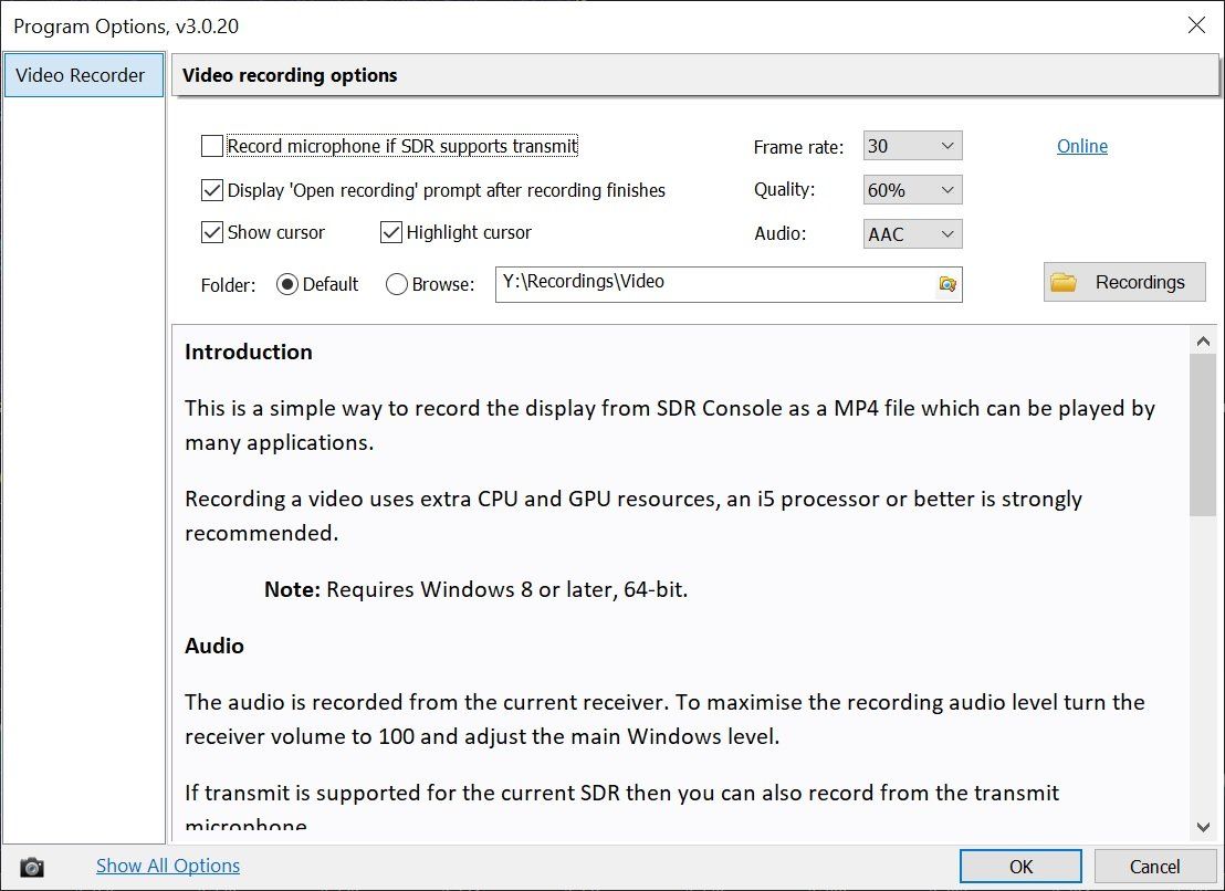

Select the Options from the ribbon bar, Rec/Playback, Video panel.
Audio
The audio is recorded from the current receiver. To maximise the recording audio level turn the receiver volume to 100 and adjust the main Windows level.
If transmit is supported for the current SDR then you can also record from the transmit microphone.
Prompt
Optionally prompt the user (that's you) to open the MP4 file when the recording finishes.
Cursor
Show the cursor, optionally enable an enhanced cursor which is recommended when making a training video.
Frame Rate
The default frame rate is 30 fps, this is the recommended value; 20 fps plays back well. A higher frame rates uses correspondingly more CPU and GPU resources.
Quality
Select the quality, a value between 40 and 100%. 40% is good, 100% excellent but uses more storage.
Audio
AAC and MP3 are supported, for Twitter videos use AAC.

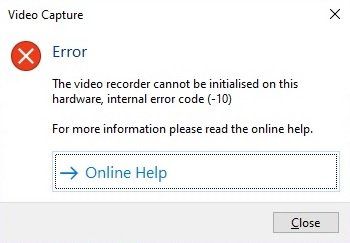

If you see the error message on the right ➤ then the video recorder will not work with your computer, sorry.
More...
The video recorder uses the Windows
Desktop Duplication API which does not support being run against the discrete GPU on a Microsoft Hybrid system. It fails with the error code DXGI_ERROR_UNSUPPORTED in such a scenario.
The only possible solution is to run SDR Console on the integrated GPU instead of on the discrete GPU on a Microsoft Hybrid system (text copied from Microsoft ):
