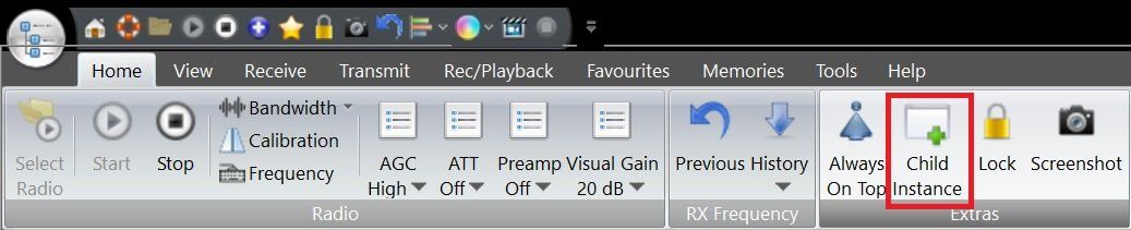

Version 3.0.25 has a Child instance button in the Ribbon bar, with one click a new instance is started.

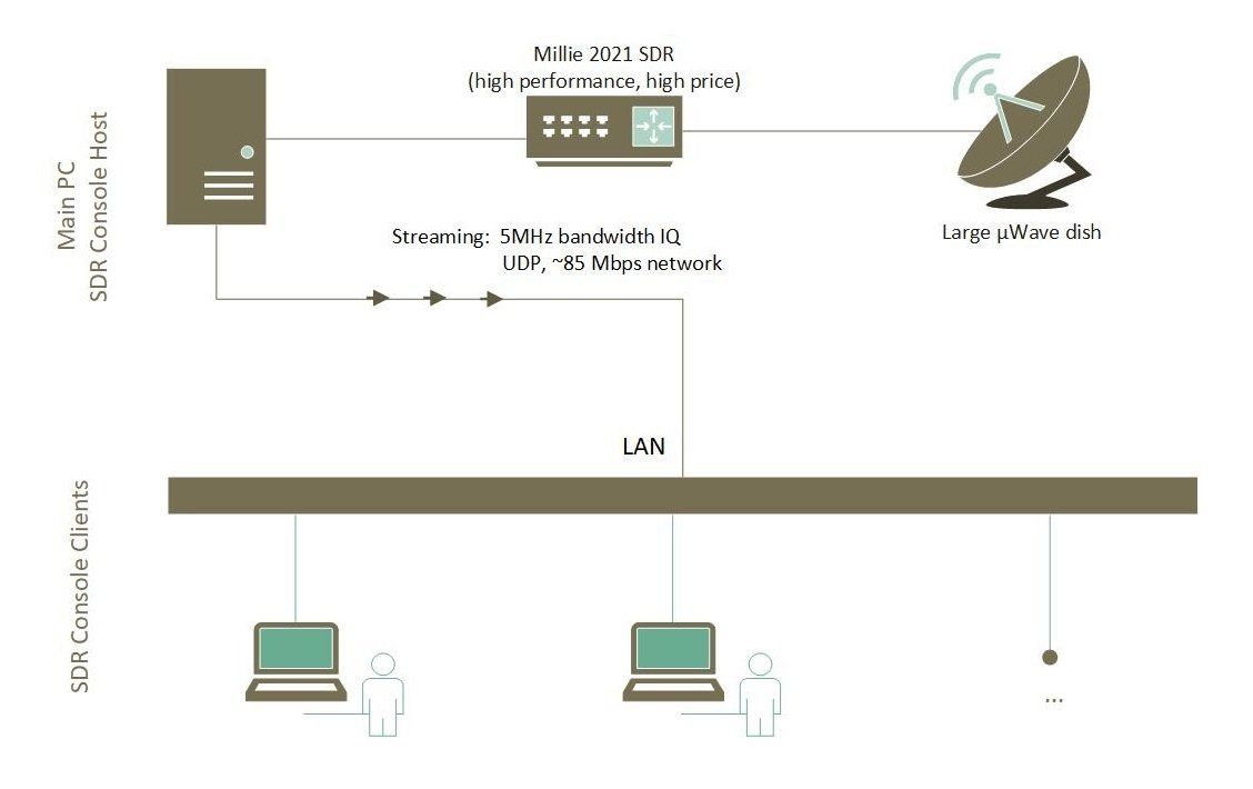

  • A specialised SDR is shared between two or more instances of SDR Console, this offers more monitors and options for analysing and recording signals.
  • The primary SDR can be a transceiver (ANAN, ELAD, Lime, Pluto) in the radio room which you monitor with your laptop.
  • Streaming is only usable on a LAN (local area network), the server supports WAN (wide area network) for remote installations.

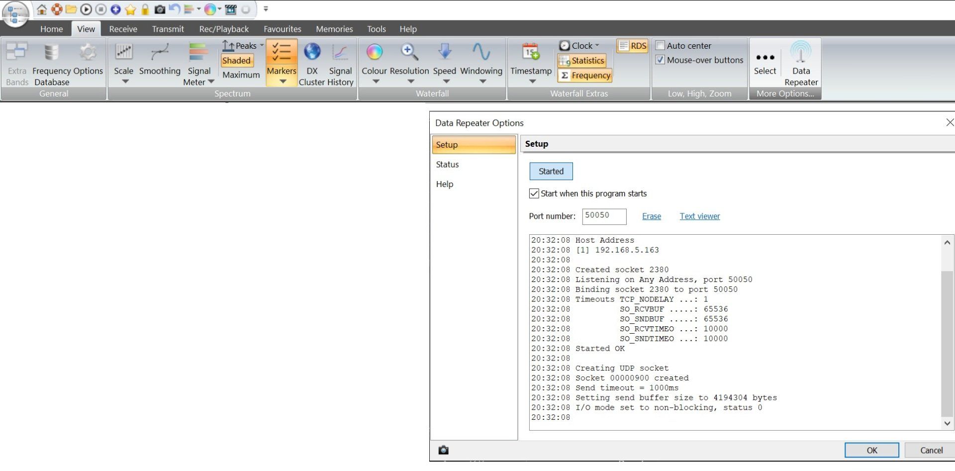

SDR Console on PC#1:
  • Ribbon Bar, View, More Options...
  • Enable Data Repeater.
  • Make sure the Data Repeater is started, note the port number.

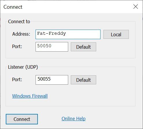

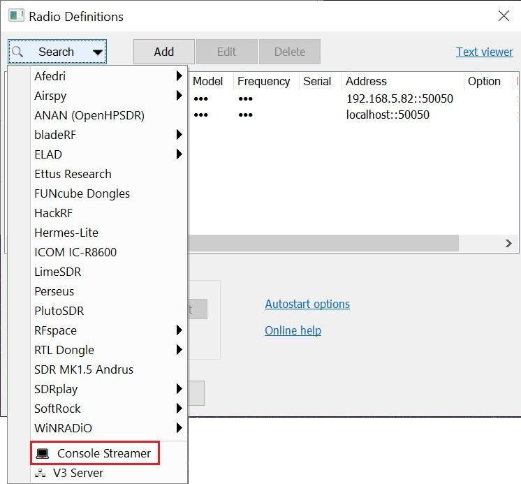

SDR Console on PC#2:
  • Select the radio definition Console Streamer.
  • Enter the name of the PC#1 computer and the port number.

Only use console streaming over the LAN (local area network). Currently the protocol uses UDP, TCP may be added later.
The bandwidth in Mbps (megabits per sample) is approximately 16 * bandwidth, so streaming 2 megabytes bandwidth requires sustainable network bandwidth of ~32 Mbps. You should be able to stream a 5 megabyte bandwidth over a wired network.

Child Instance
The Child Instance:
  • Has Child :: in the program's title bar.
  • Automatically starts the connection to the main instance.
  • Closes when the main instance closes.
  • Closes if the radio is stopped in the child instance.
  • Saves own window position and pane layout.
  • Does not save settings such as speed, palette selection - the settings from the main instance are used at startup.
  • Only supports receive, not transmit.
