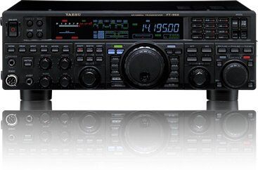

The External Radio option provides 'pan-adaptor' support for standard HF / VHF radios such as the Yaesu FTDX-3000. A SDR receiver such as the Airspy HF+ or RSP1A is synchronised with the radio using a serial port interface for frequency/mode control. the SDR uses either the same antenna as the radio or takes a signal from an IF output socket.
