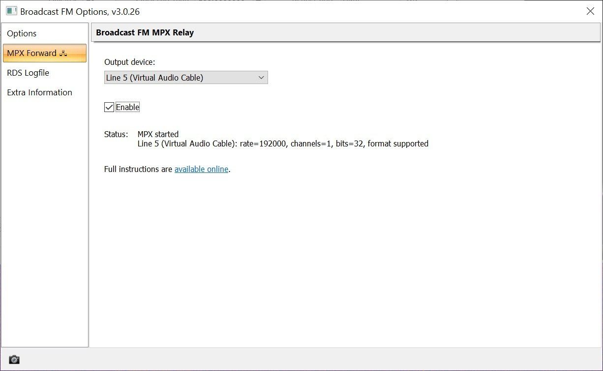

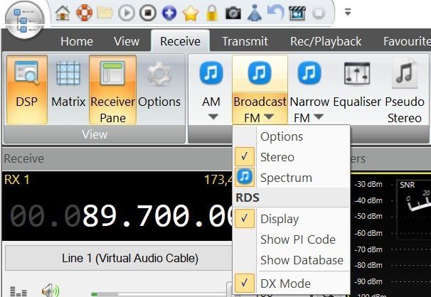

From the ribbon bar select the BFM Spectrum display. In this display select the Options (•••), in the Broadcast FM Options select MPX Forward.

- Select a VAC definition from the Output device dropdown.
- Make sure Enable [X] is checked.
- If running the status text will be as shown below.

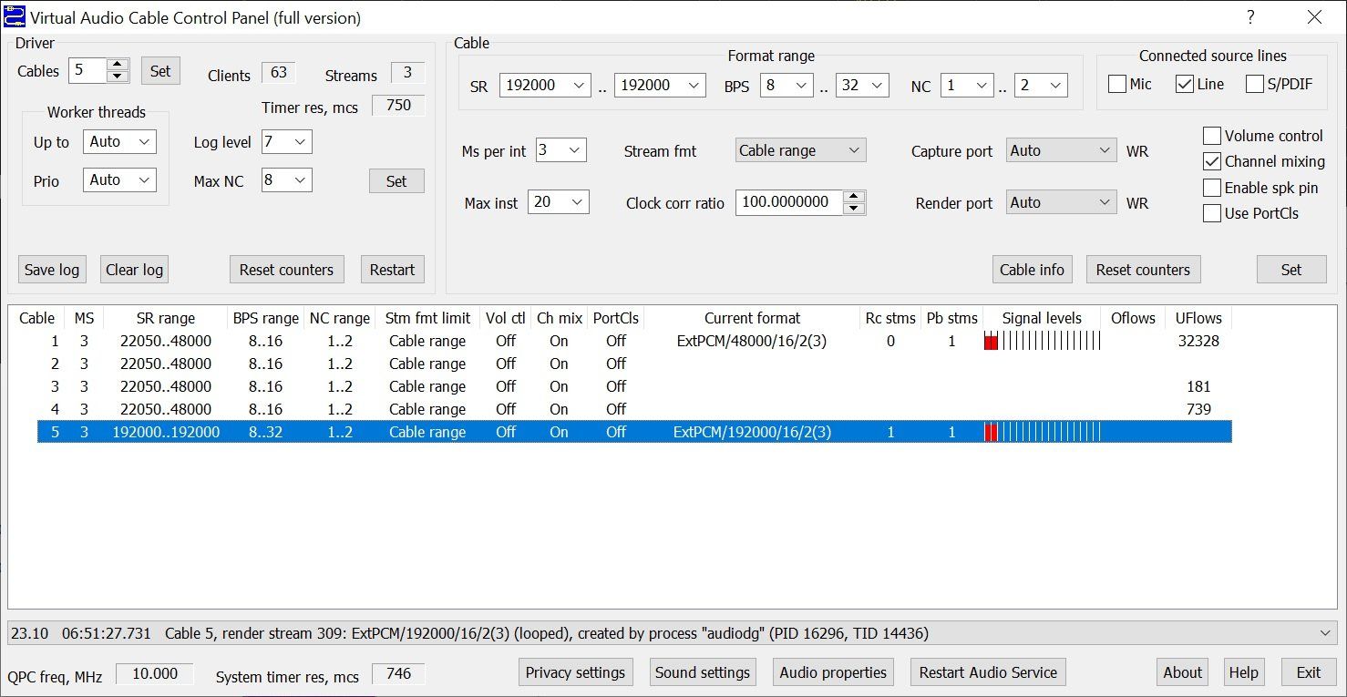

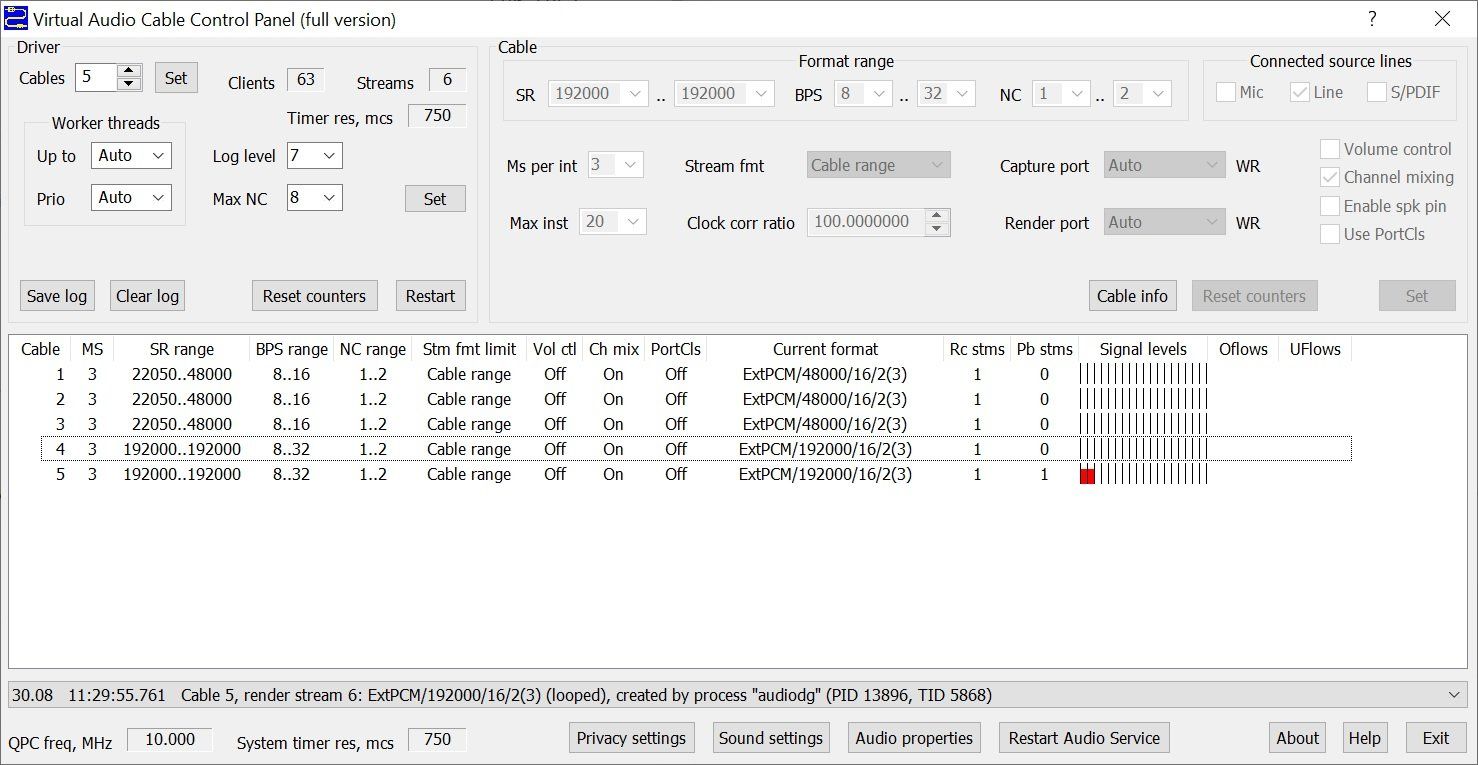

Looking at Cable 5 in the Virtual Audio Cable Control Panel:
- SR (Sample rate) must be set to 192000, 192000
- BPS (Bits per sample) must be set to 8 to 32

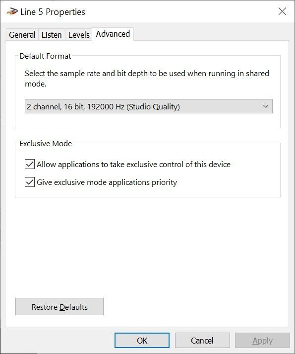

Advanced Properties
In addition, the Advanced properties should be set to:
- 2 channels,
- 16 bits,
- 192000 Hz.

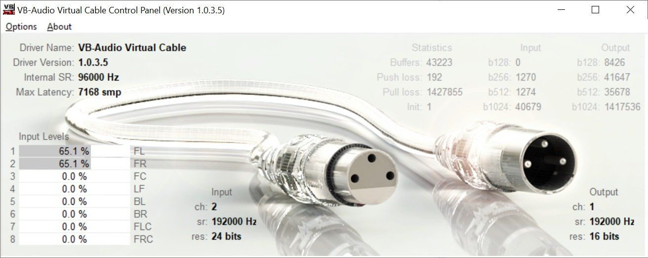

VB Audio
Website https://vb-audio.com/Cable/index.htm
Looking at the VB Audio Virtual Cable Control Panel:
- SR (Sample rate) must be 192000, 192000
- From the Options menu select internal sampling rate to 96000 Hz.

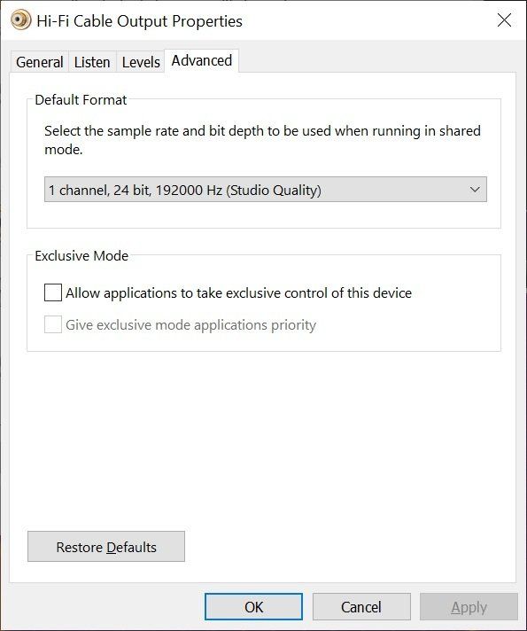

Advanced Properties
- 1 channel,
- 24 bits,
- 192000 Hz.
