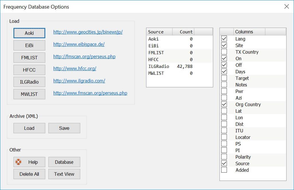

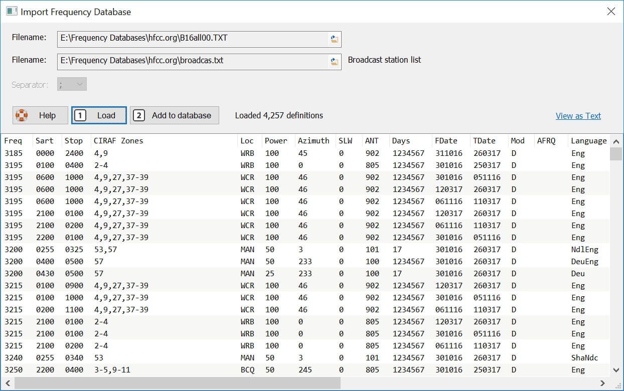

Loading A Database
Import
- Select the file to be imported,
- Press Load. The load status will be shown, for example Loaded 4,257 definitions.
- Press Add to Database. Either:
- Add the definitions (all current definitions are kept), or
- Replace existing definitions for the current database.
- When the definitions have been added close this window.

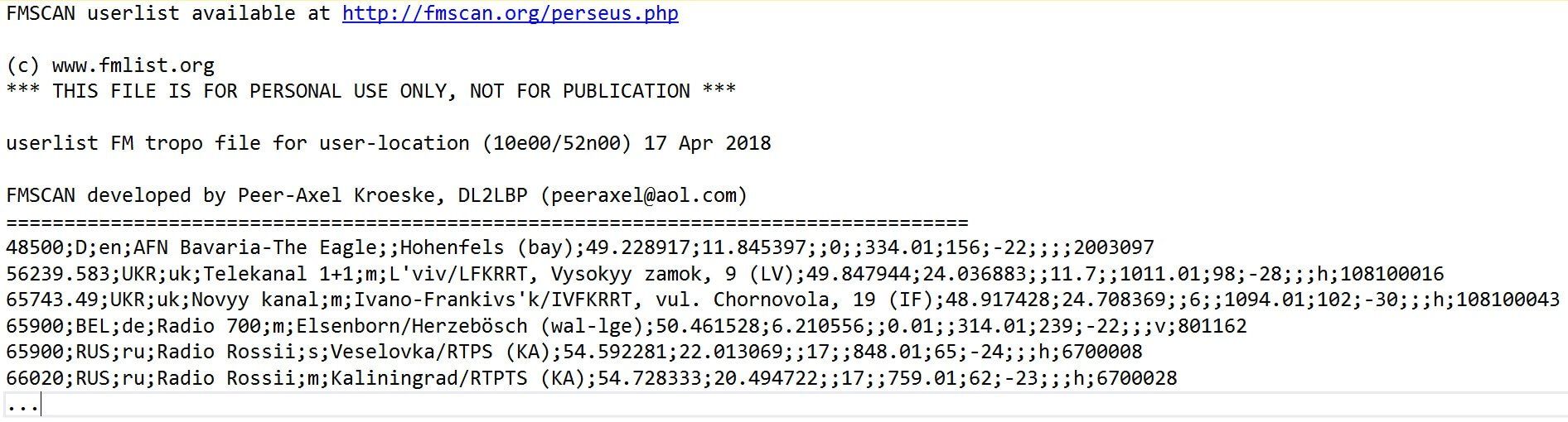

FMLIST
- FM+ (Tropo)
- FM+ (Meteor Scatter)
- Sporadic E
- Semicolon

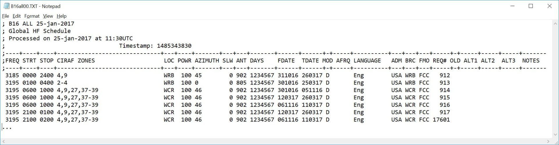

HFCC

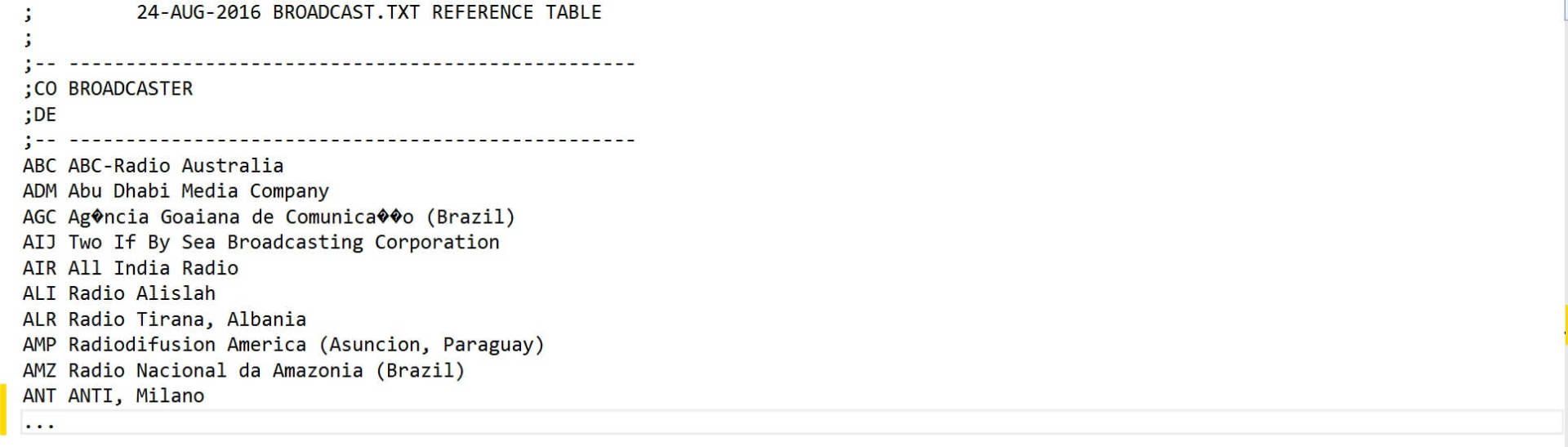

- A18all00.txt (name depends on the ZIP archive),
- Broadcas.txt

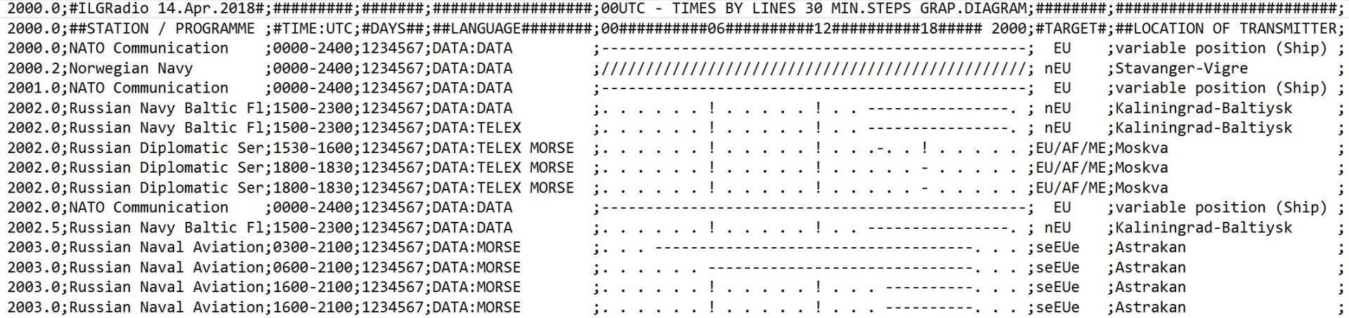

ILGRadio

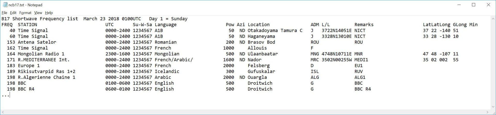

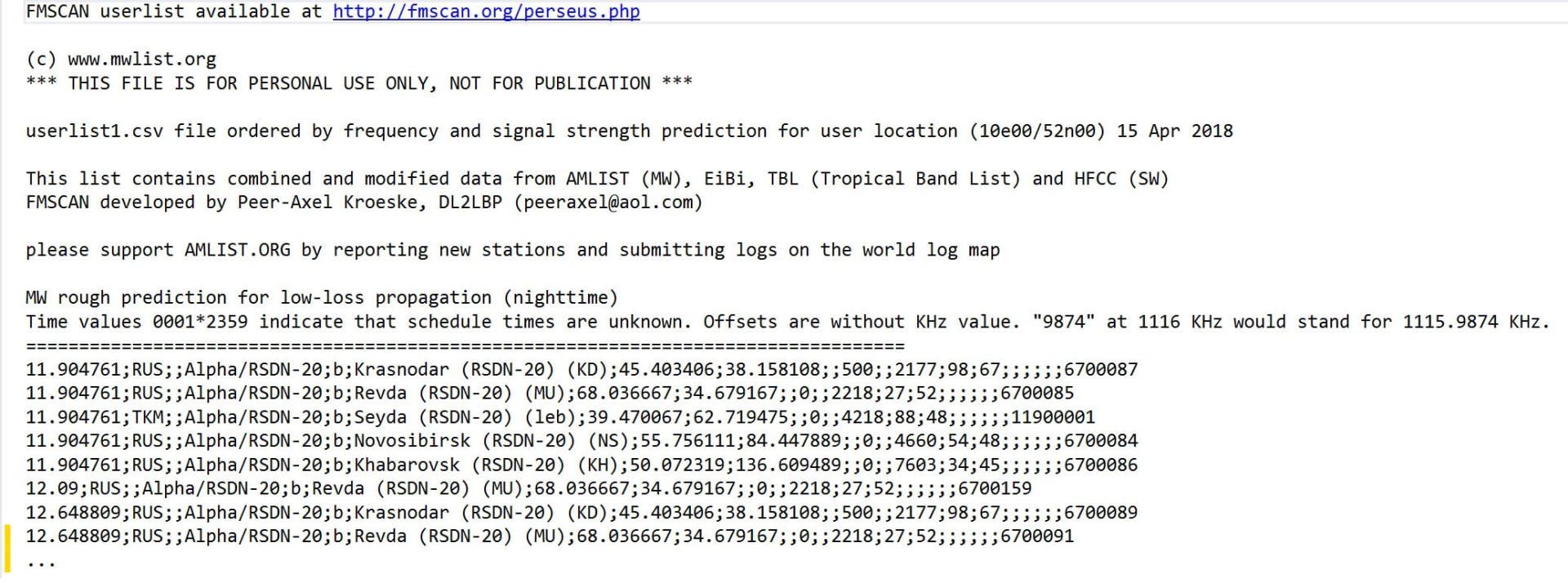

MWLIST
- LW/MW/SW (0-30 MHz)
- Semicolon

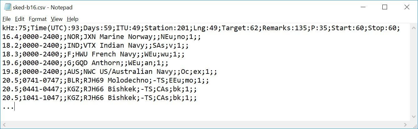

SWSKEDS
- Download the latest CSV zip file from htps://groups.io/g/swskeds/files .
- Extract All files in your Downloads directory.
- Launch SDR Console, on the ribbon bar click on View tab, Frequency Database. Click on the Frequency Database Options button [...].
- Click the Custom CSV button, select -> Load custom file.
- Click in top Directory Open icon and navigate to your Downloads directory. Double-click the extracted Directory from step 2
- Selected the *.csv file and click Open.
- Select 1 Load, wait for data to load.
- Select 2 Add to database, When asked, choose -> Replace. Wait for data to load. Note that the frequencies are in Hz.
