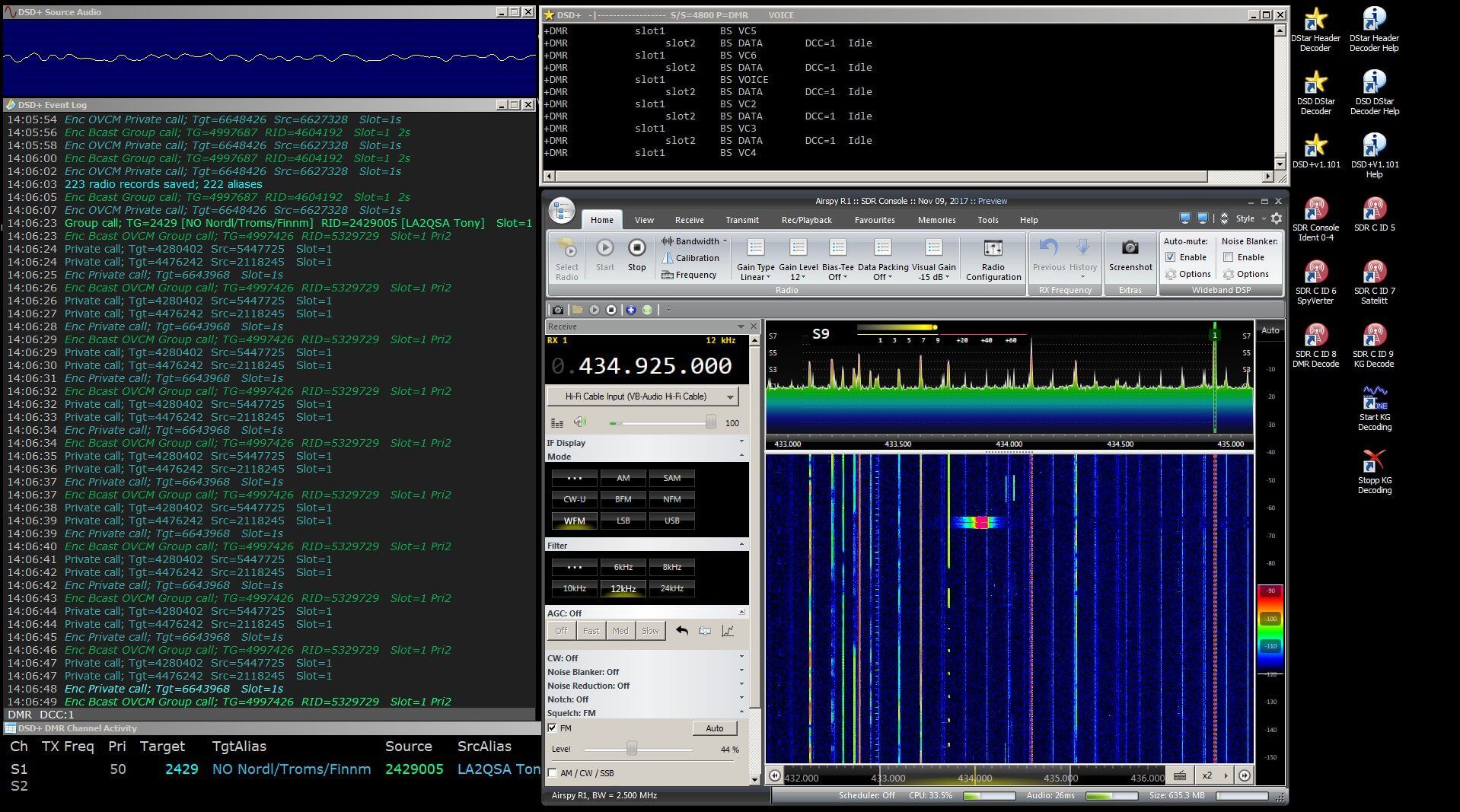

Console
Wide FM
In the console select WFM (Wide FM) and set the filter bandwidth to 12kHz. It is essential that you select Wide FM as there is no de-emphasis unlike Narrow FM.
The output device selection is a virtual audio cable (VAC), see below.
Virtual Audio Cable
DSDPlus reads the demodulated audio from the console over a virtual audio cable at a bandwidth of 48 or 96 kHz (48kHz is recommended).
Examples of virtual audio cables are:
VB Audio from VB-Audio Software,
Virtual Audio Cable from Eugene Muzychenko.
Screenshot
Below is a screenshot courtesy of a user group member, you see the correct console settings. "Running fine with my NUC i5, 4th gen. Win 7 Home Premium, 64bit."
