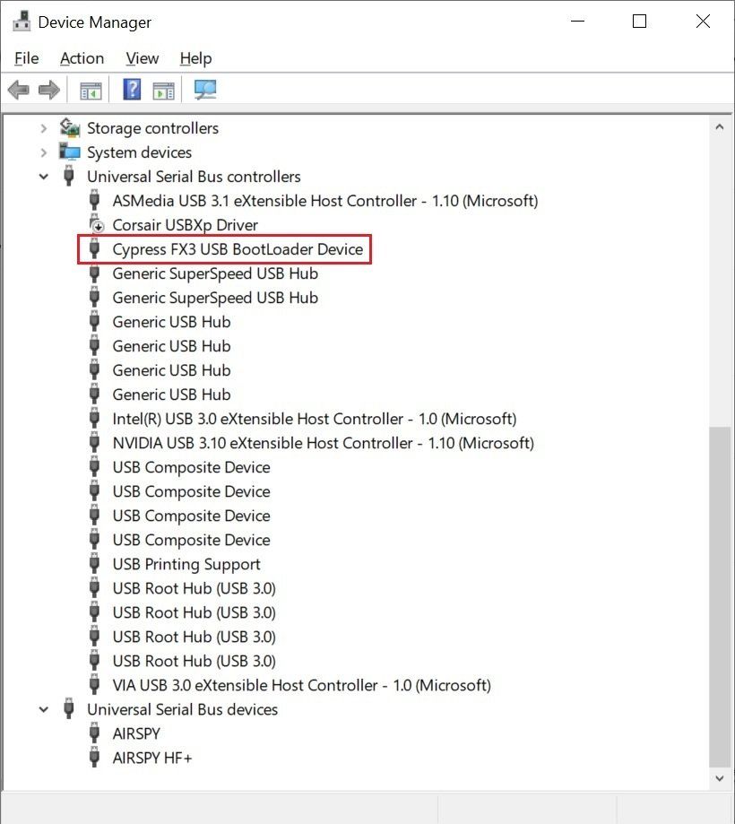

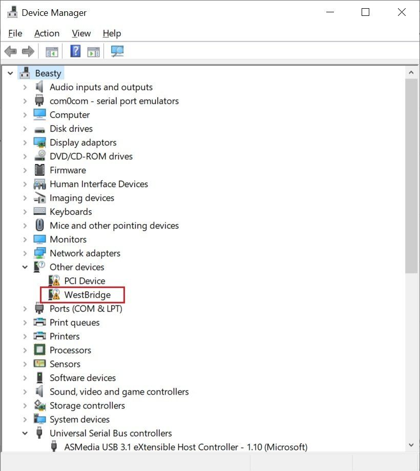

Driver
When you connect the RX-666 to your computer it will either show up as a WestBridge or Cypress FX3 device.
If Cypress FX3 then drivers are already installed. If WestBrige then you must install the Cypress FX3 driver:
- Right-click on WestBridge
- Select Update driver
- Select Browse my computer for driver software
- Select the folder with the drivers which correspond to your operating system, Windows 10 drivers 1.2.3.20 are available on the Cypress website and below.
