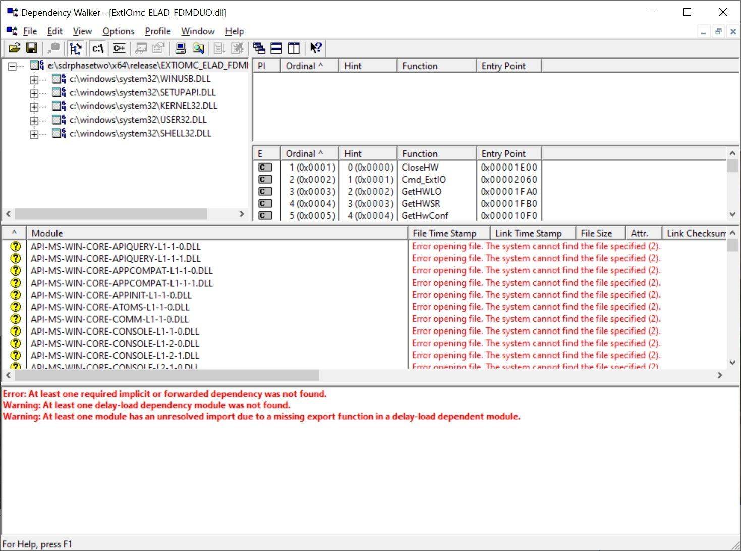

Download, install, start. From the File menu select the dll or executable to be analysed. In the example below the dll ExtIOmc_ELAD_FDMDUO.dll is being analysed.

Errors
You can ignore the errors shown below.
  • Error: At least one required implicit or forwarded dependency was not found.
  • Warning: At least one delay-load dependency module was not found.
  • Warning: At least one module has an unresolved import due to a missing export function in a delay-load dependent module.

If an essential dll on which ExtIOmc_ELAD_FDMDUO.dll depends cannot be found the corresponding folder (top left) will be shown in red. In the image below all dlls:
๐Ÿ“ WINUSB,
๐Ÿ“ SETUPAPI,
๐Ÿ“ KERNEL32,
๐Ÿ“ USER32 and
๐Ÿ“ SHELL32
can be loaded, all is good.
