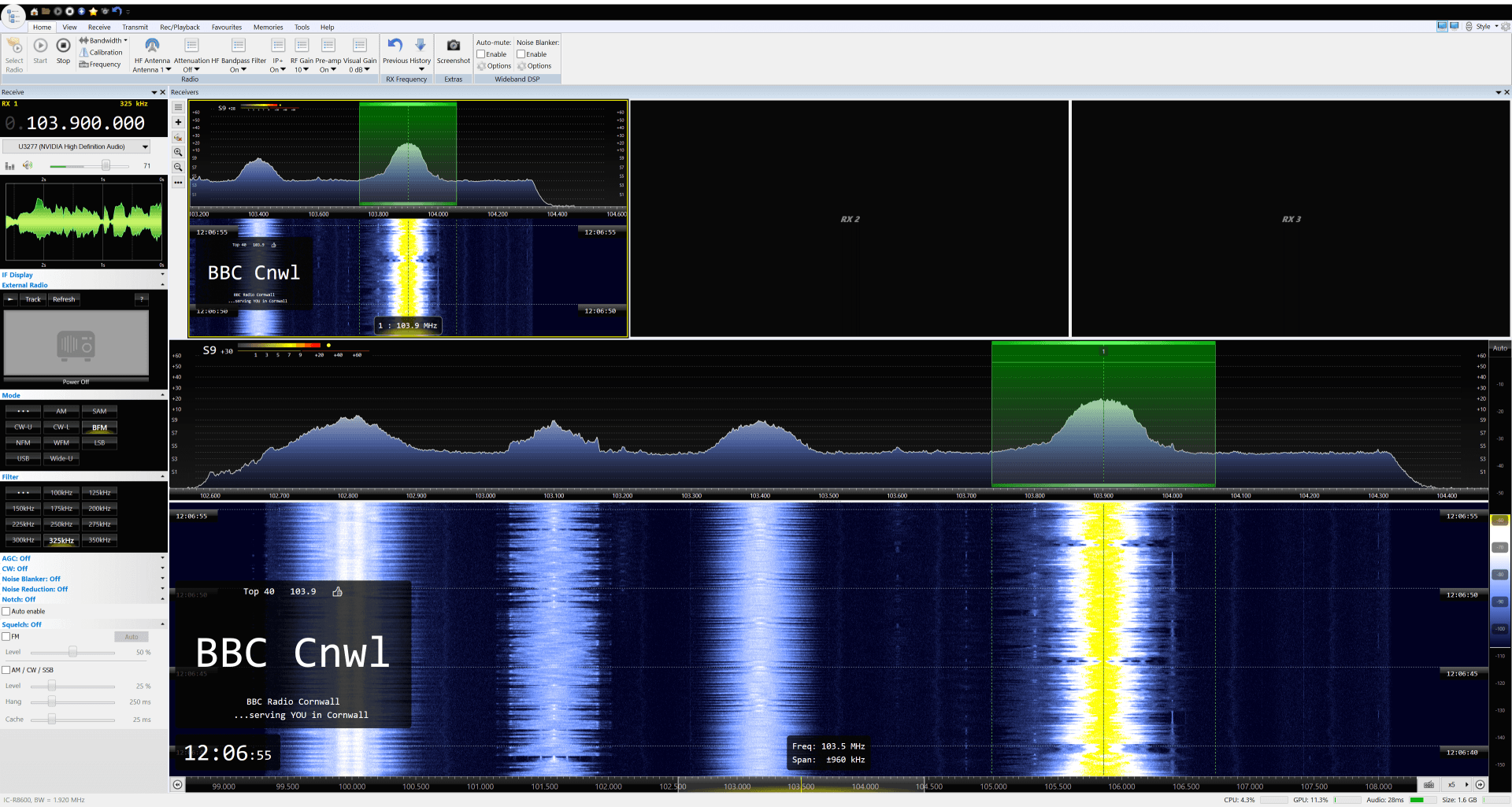

Initial support added on June 26th, 2018. Available in version 3.0.1. Based on two days of use on HF and VHF this is an excellent radio!

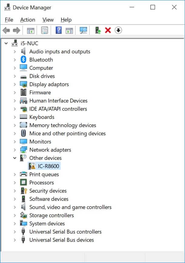

  • From the Control Panel select Device Manager
  • Right-click on IC-R8600 in the Universal Serial Bus devices

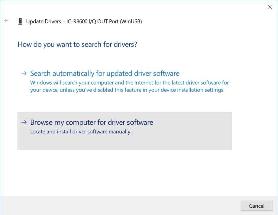

  • Select Update driver from the context menu

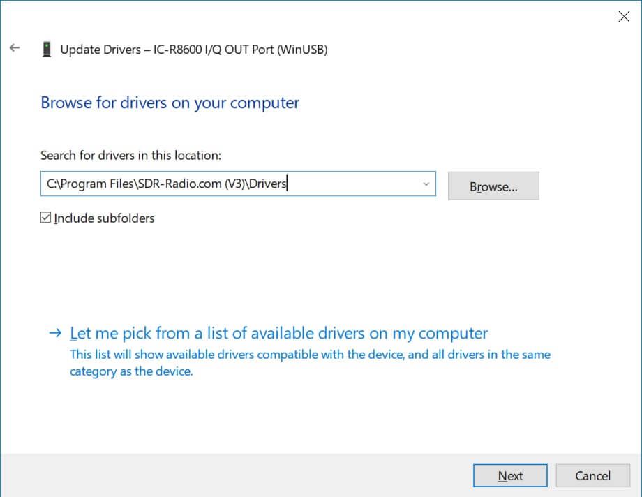

  • Select Browse my computer for driver software (location depends on the folder where SDR Console is installed)
  • 32-Bit: select ICOMR8600.inf from C:\Program Files\SDR-Radio.com (V3)\Drivers/Win8Win10/x86
  • 64-Bit: select ICOMR8600.inf from C:\Program Files\SDR-Radio.com (V3)\Drivers/Win8Win10/x64

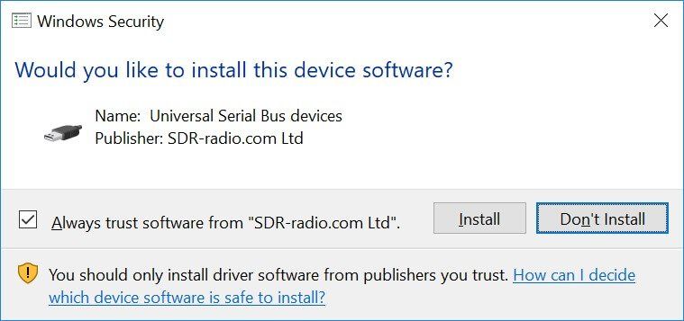

  • Windows Security will prompt you to confirm the installation, the driver is signed by SDR-Radio.com Ltd

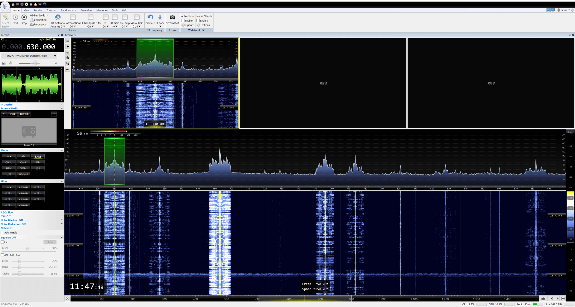

DC Spur
The I/Q data contains a DC component that is produced in the signal processing. The DC component appears as a constant frequency component positioned at the center frequency (0 Hz). Although this is removed in SDR Console it is recommended that you do not tune stations to the centre of the display as the spur removal code will affect this signal as well.
