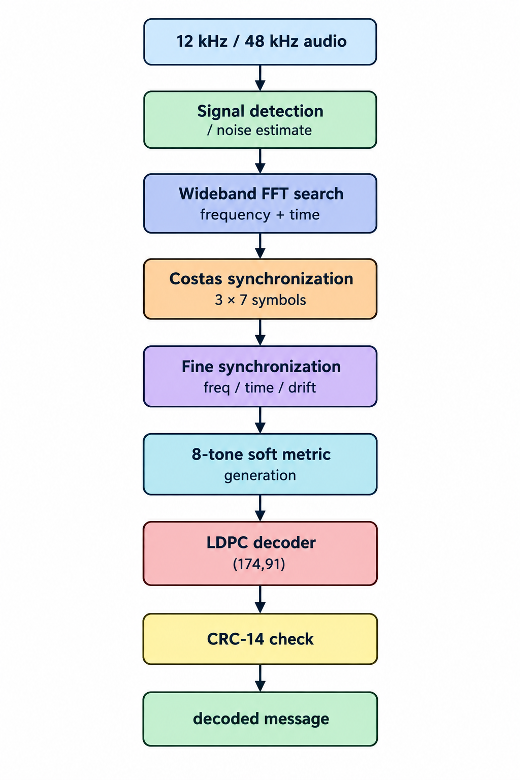

The really interesting part is that the LDPC decoder isn't necessarily where the biggest gains are. The front end and candidate generation are extremely important.
I'd build it as a multi-stage decoder, something along these lines:

1. Much better signal detection
Rather than simply looking for obvious FT8 traces in an FFT, I'd exploit the known Costas structure.
The three Costas blocks are known completely, so we effectively have a matched-filter/reference-correlation problem.
That lets us search for:
  • frequency,
  • fractional symbol timing,
  • frequency drift,
  • signal amplitude,
  • phase,
  • possibly time offset
simultaneously.
This is very similar philosophically to what we've been doing with your DVB-S2 SOF/PLHEADER detector.
2. Proper soft 8-FSK metrics
This is where I think we could make a significant improvement.
For every data symbol I'd calculate something like:
E0 E1 E2 E3 E4 E5 E6 E7
and convert those eight tone energies into soft bit LLRs.
Because each tone represents three Gray-coded bits, we can calculate the exact bit likelihood:
  • LLR(bit0)
  • LLR(bit1)
  • LLR(bit2)
rather than making a hard decision on the strongest tone. That gives the LDPC decoder substantially better information.
This is analogous to the lesson we found with your DVB-S2 QPSK decoder: the quality and scaling of the soft information going into LDPC can matter enormously.
3. Better LDPC decoding
FT8's code is LDPC(174,91), with the 91 bits consisting of the 77-bit message plus the CRC.
I'd initially implement:
  • normalized/offset min-sum,
  • sum-product,
  • layered scheduling if applicable,
  • adaptive damping,
  • early termination,
  • CRC-assisted termination.
But I'd also investigate OSD / ordered-statistics decoding as a second-stage decoder. That's particularly interesting for FT8 because the block is tiny. Some modern implementations already experiment with BP, OSD and a-priori-assisted decoding.

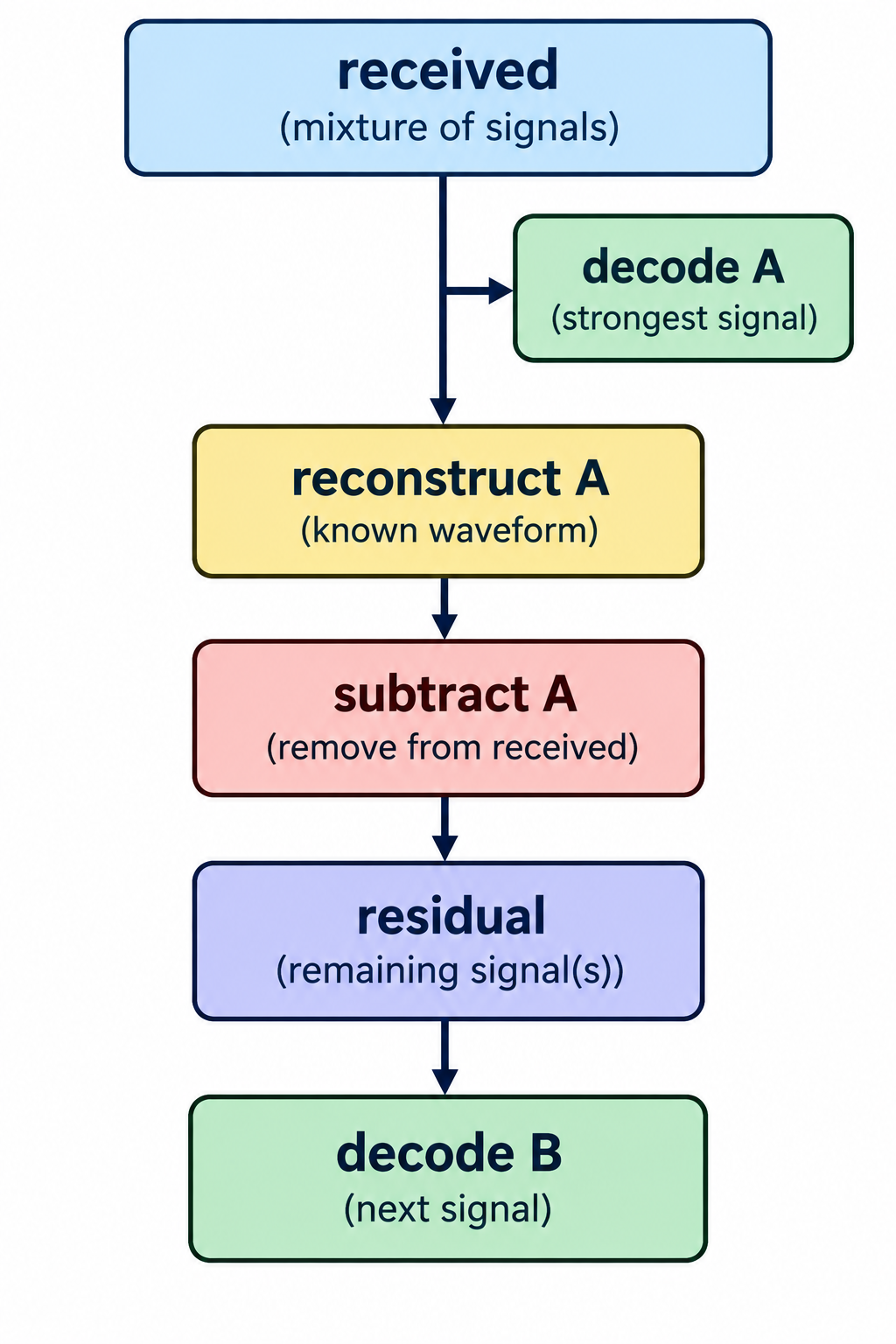

5. Multi-signal decoding
This is where I'd really like to push it.

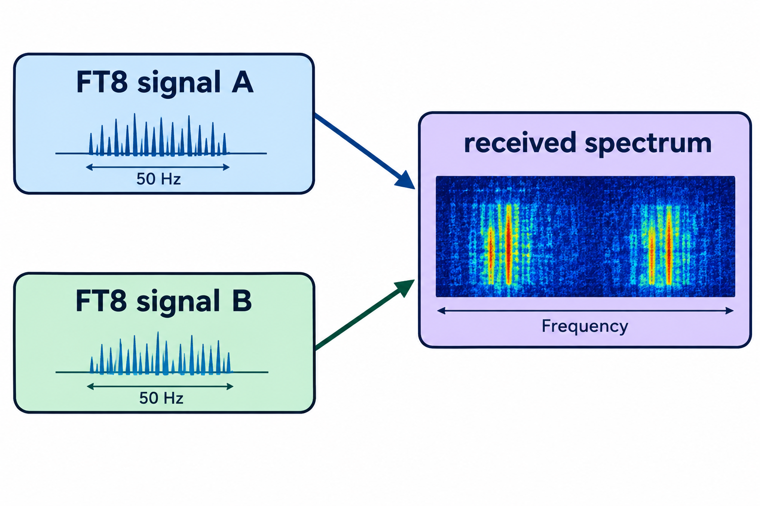

Imagine:
We decode A.
Once A is known, we know exactly what waveform A should have produced.
So:
That can potentially expose signals that were completely buried underneath stronger FT8 transmissions. The original WSJT-X development notes explicitly contemplated signal subtraction and two-pass decoding.

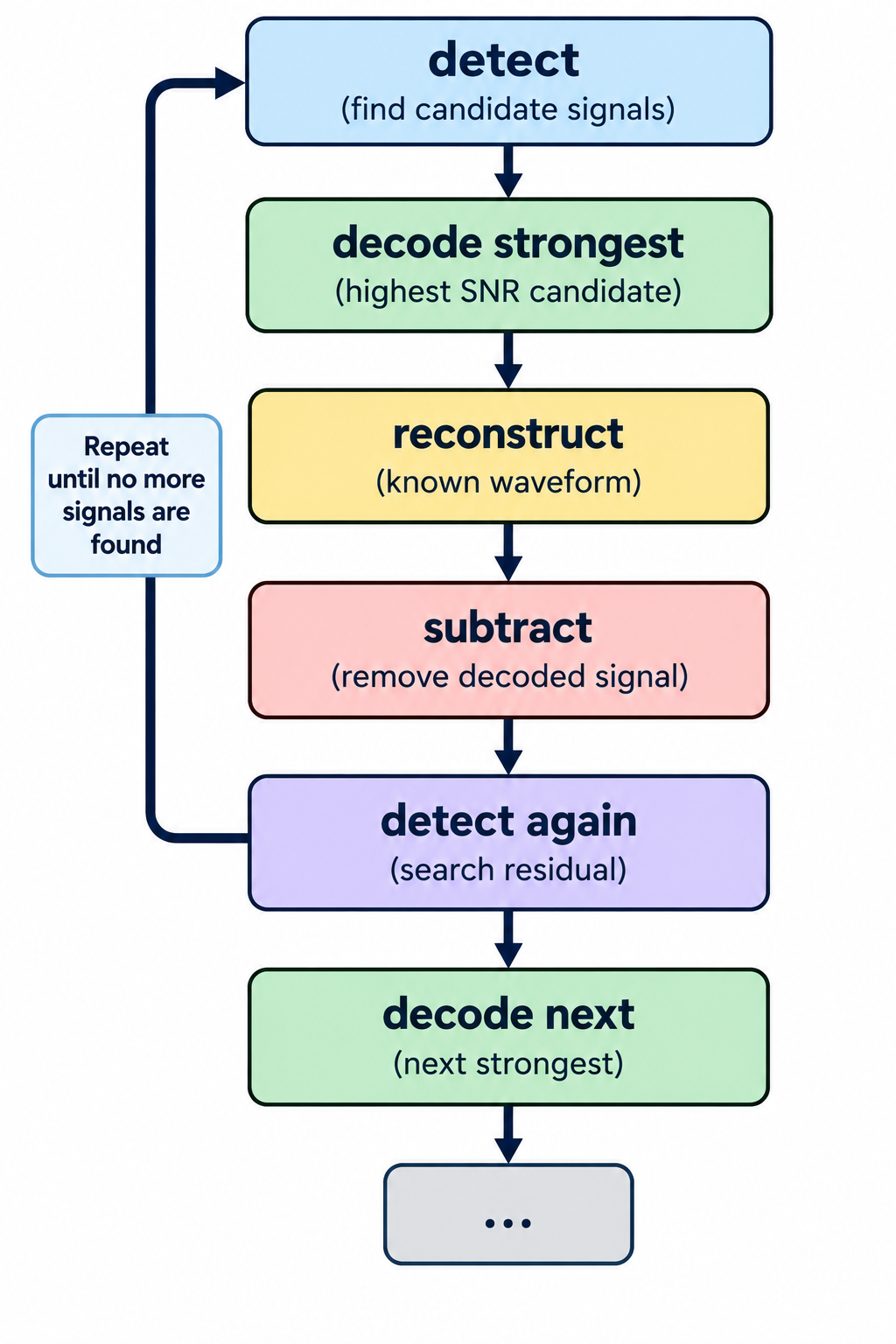

I'd go further and make it iterative:

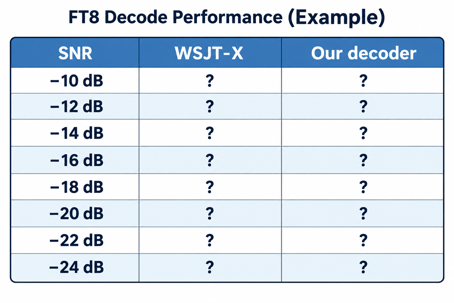

And there's a particularly interesting experiment I'd like to do. Rather than immediately trying to beat WSJT-X, I'd build a reference-quality C++17 decoder and compare it against WSJT-X under controlled conditions.
For example:
Generate thousands of known FT8 messages at each SNR, with controlled:
  • frequency offset
  • timing offset
  • frequency drift
  • AWGN
  • fading
  • adjacent signals
  • overlapping signals
and measure actual decode probability.
That would let us identify where the extra dB are coming from, rather than just saying "it decodes better".
FT8 is already capable of roughly −20 dB-class decoding under suitable conditions, with AP decoding providing additional sensitivity. And I think your existing DSP experience would transfer extremely well.
