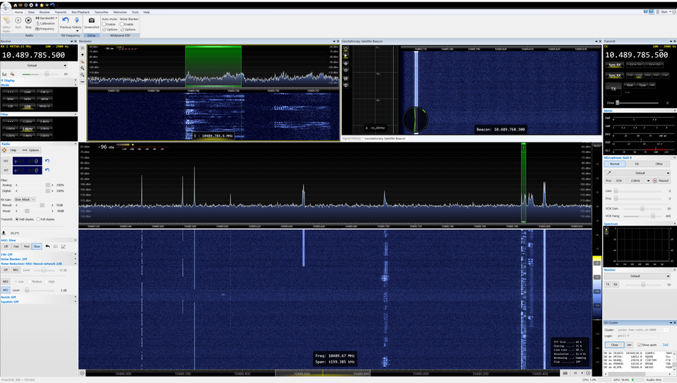

Shows suggested settings for Pluto
Here's a screenshot of my Pluto SDR on Es'Hail 2, this screenshot shows the suggested settings for Pluto (bottom left-hand side).
Note the RX Gain is set to Slow Attack (Manual value is ignored) and the Visual is set to -40dB.
