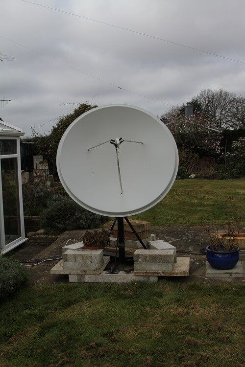

One of my Pluto units has been modified to use an external 40 MHz reference input, I use a unit from Leo Bodnar so it's nice and stable.
The pluto drives a CN 0417 pre-amplifier which in turn is driving a SG Labs 20W amplifier, output ~ 5W.
