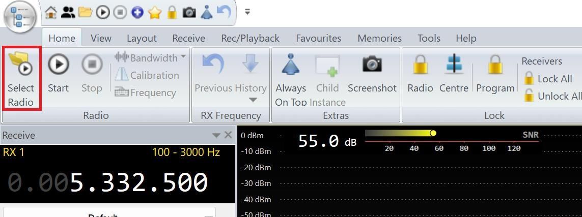

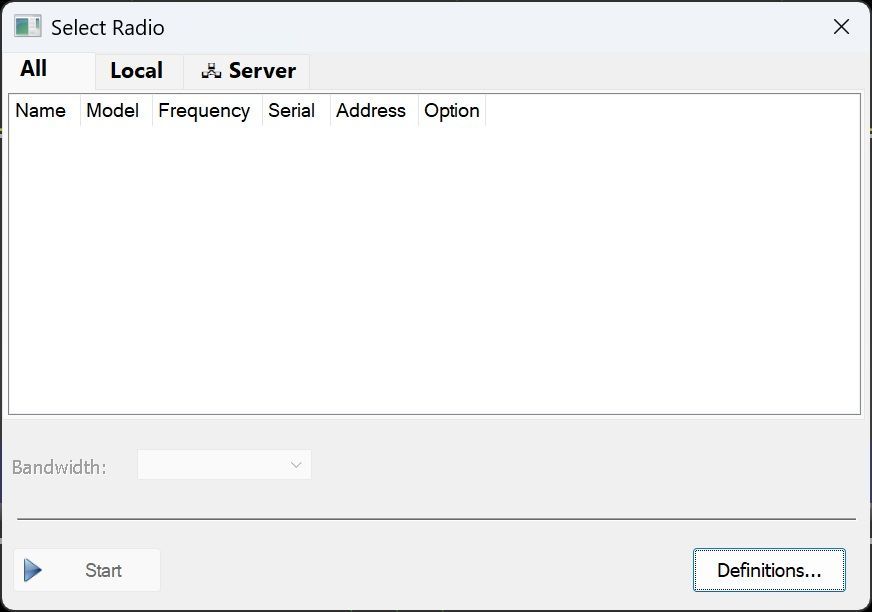

  2. From the Home tab on the ribbon bar, in the Radio panel click Select Radio, the Select Radio window is displayed.

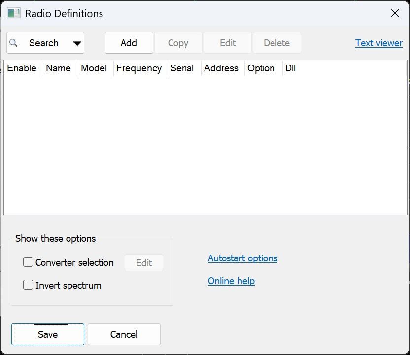

  3. At the bottom right of the Select Radio window, click Definitions..., the Radio Definitions window is displayed.

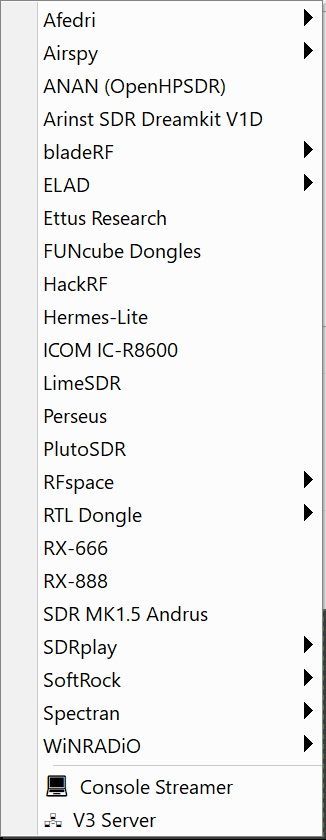

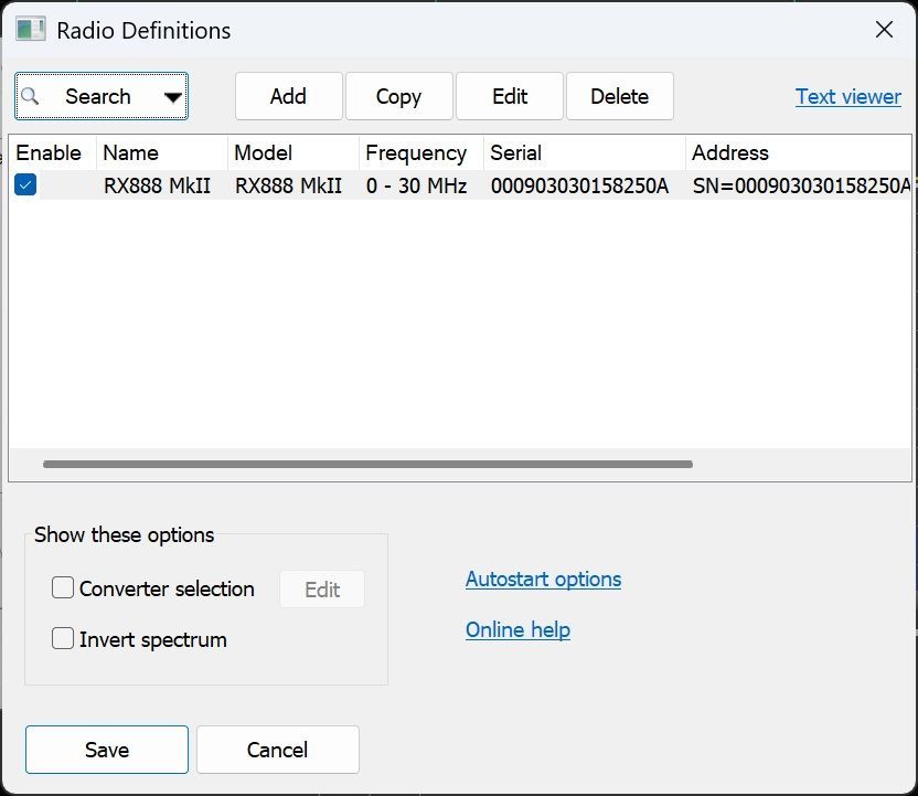

  4. At the top left of the Radio Definitions window click Search, a list of all supported radios is displayed.
  5. Select the radio you want to add, for example Airspy, SDRplay. In this example the RX-888 will be added.
  6. When you select an option from the list in step 4, either a radio is found or not.

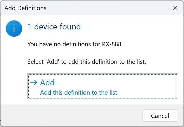

  7. If the radio is found, a window is displayed with the option of adding the new definition.

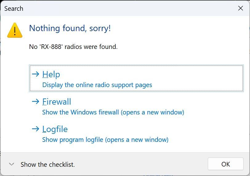

  8. If the radio is not found, an error window is displayed. If this is a radio connected by USB, make sure the USB port can supply enough power.
  9. After adding the definition, click Save in the Radio Definitions window.

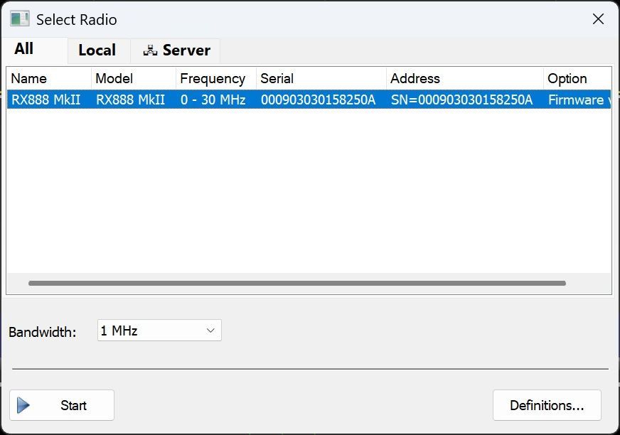

  10. You can now select your radio in the Select Radio window.
