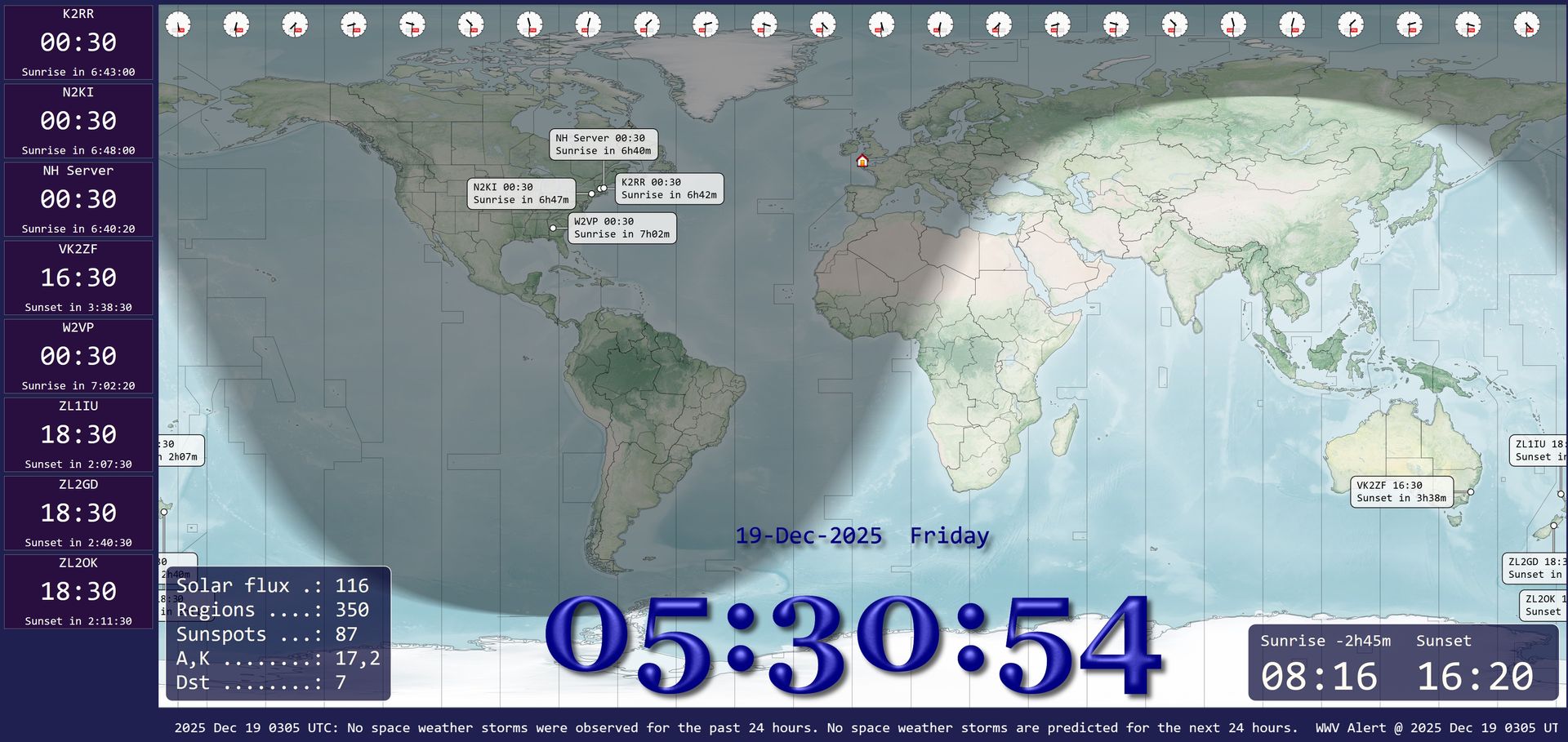

Corrected Clock Display
The clock display now correctly supports fonts with non-standard text metrics such as Georgia. These fonts are, of course perfectly legal, it was an oversight in this program which prevented their correct display.
To select a system font use the ribbon bar entry: Clock, Font, System Fonts. The image below shows Georgia.

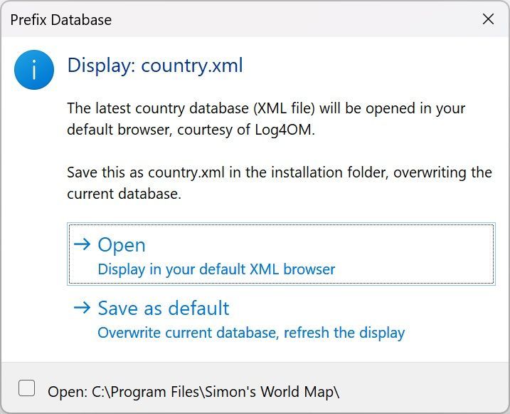

Country Prefixes
The database shipped with this kit is the very latest available from Log4OM, update timestamp is 2025-08-05 09:52:27z.
Updating the database has been simplified: from the ribbon bar select Prefixes, Database.
  • Select Open to display the latest available database in your default XML browser, usually Microsoft Edge or Google Chrome.
  • Select Save as default to overwrite the current database with the latest available database. Sanity checks are applied, the display refreshed.

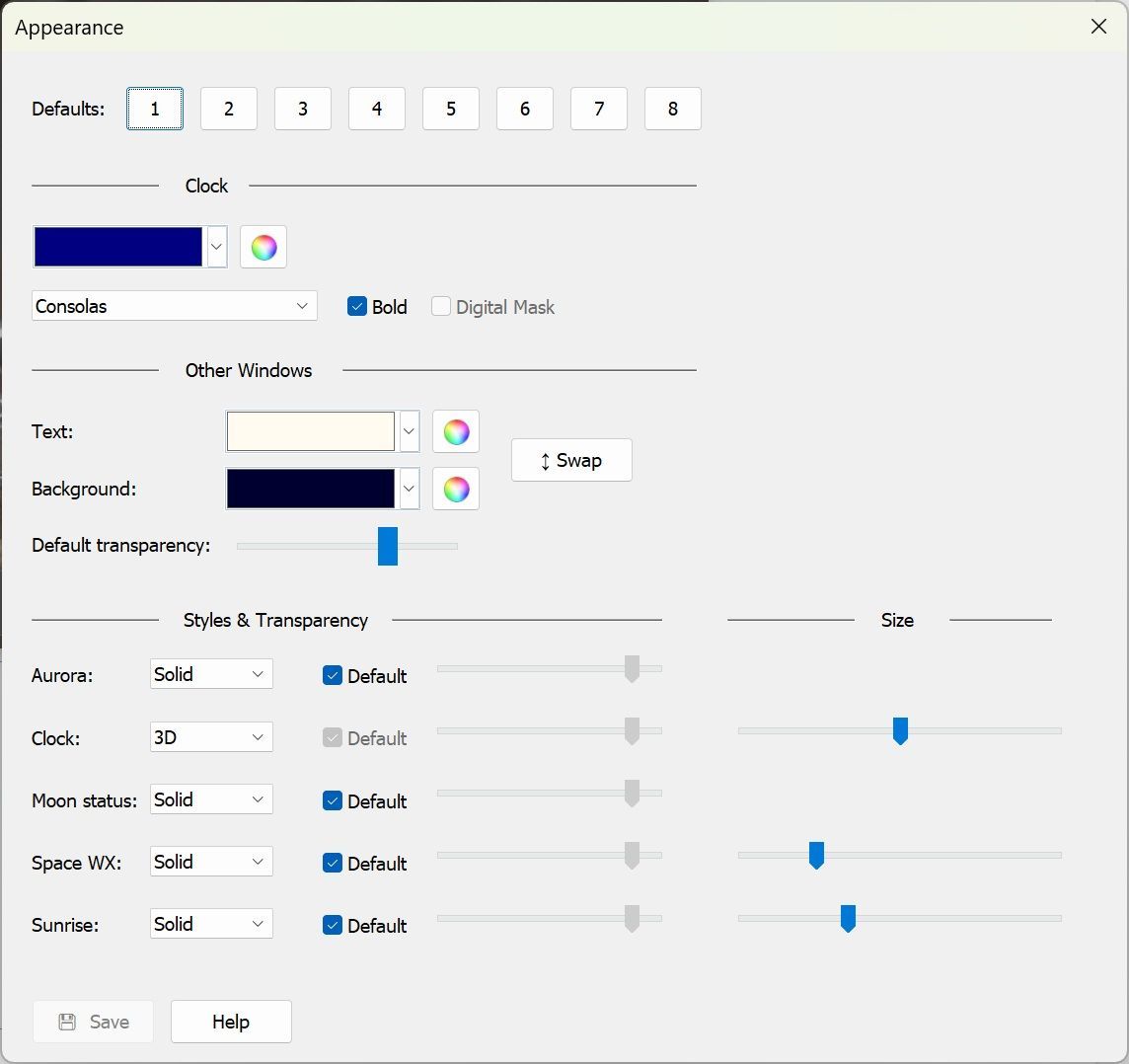

Appearance

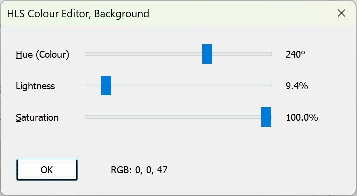

The Appearance window has been refreshed, simplified. The defaults have been changed to have a dark background and a light text. A HLS (Hues, Lightness, Saturation) colour editor has been added, selected from the colour-wheel button to the right to the main colour-selection options.
The Space weather and Sunrise windows now have a border, drawn with the text colour.
Aurora
The aurora legend has been increased in size to make it easier to read.
Clock
The clock now has its own colour setting (see Appearance above).
