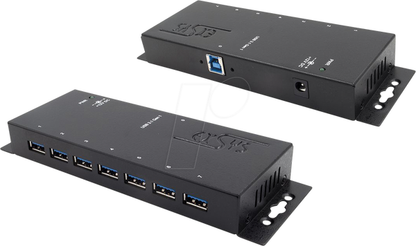

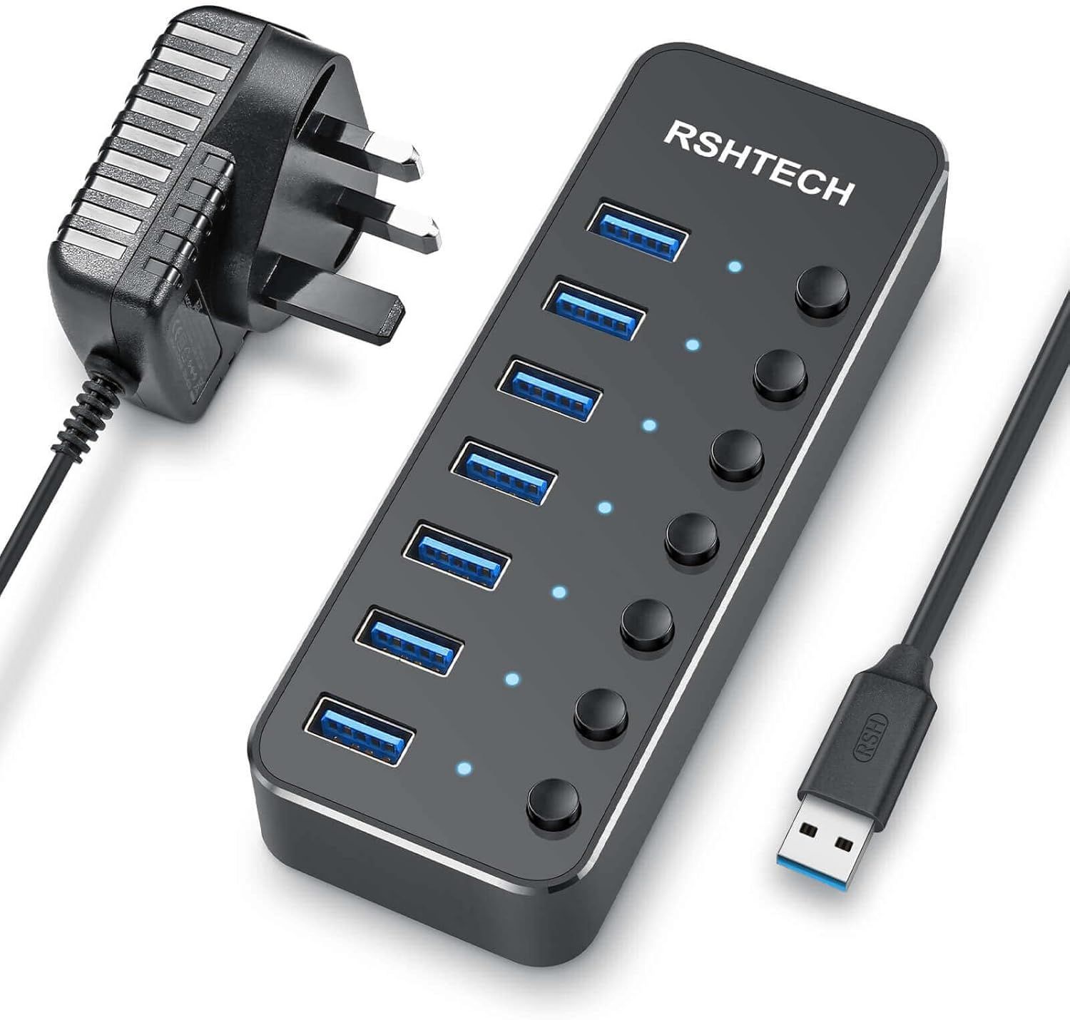

Today I found the cause. The power supply for a USB hub had gone 'wonky', generating lots of noise which was radiated by the devices attached to the hub, such as 2 x Airspy Discovery, Perseus, ELAD S1 and S2, NetSDR.
This is not the first time I've had a PSU on these hubs go bad, so I replaced the hub with a good semi-commercial Exsys hub which was sitting in the cupboard, and now the problem is solved.
