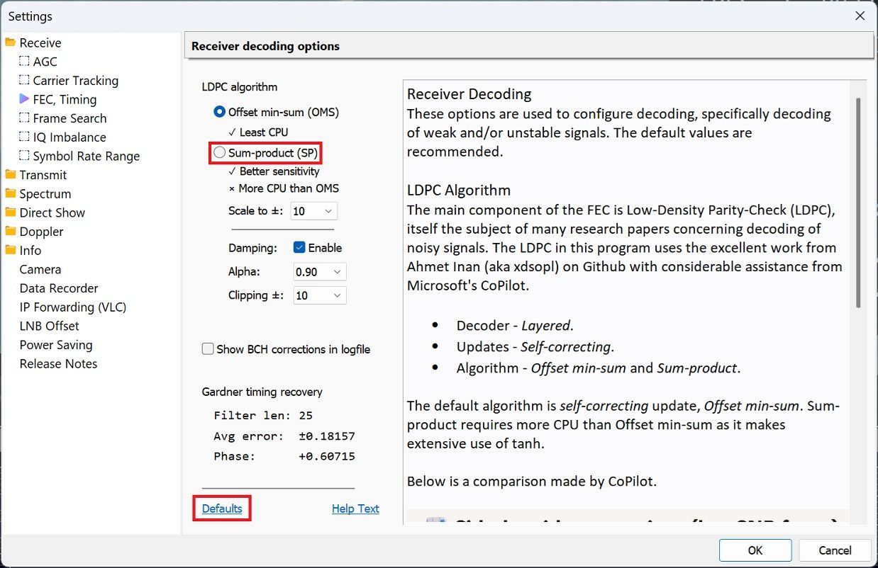

FEC - LDPC
There are now two LDPC algorithms,
  • Offset min-sum, and
  • Sum-product.
Sum-product is more sensitive than offset min-sum but currently doesn't work at all for FEC rates lower than 1/2 (1/4, 1/3 and 2/5). When sum-product is selected and the rate is lower than 1/2 then offset min-sum is used. The default damping settings for sum-product are shown below.
The aim is to work on sum-product with the help of ChatGPT in 2027 to get the maximum possible sensitivity.
