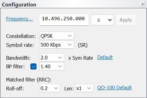

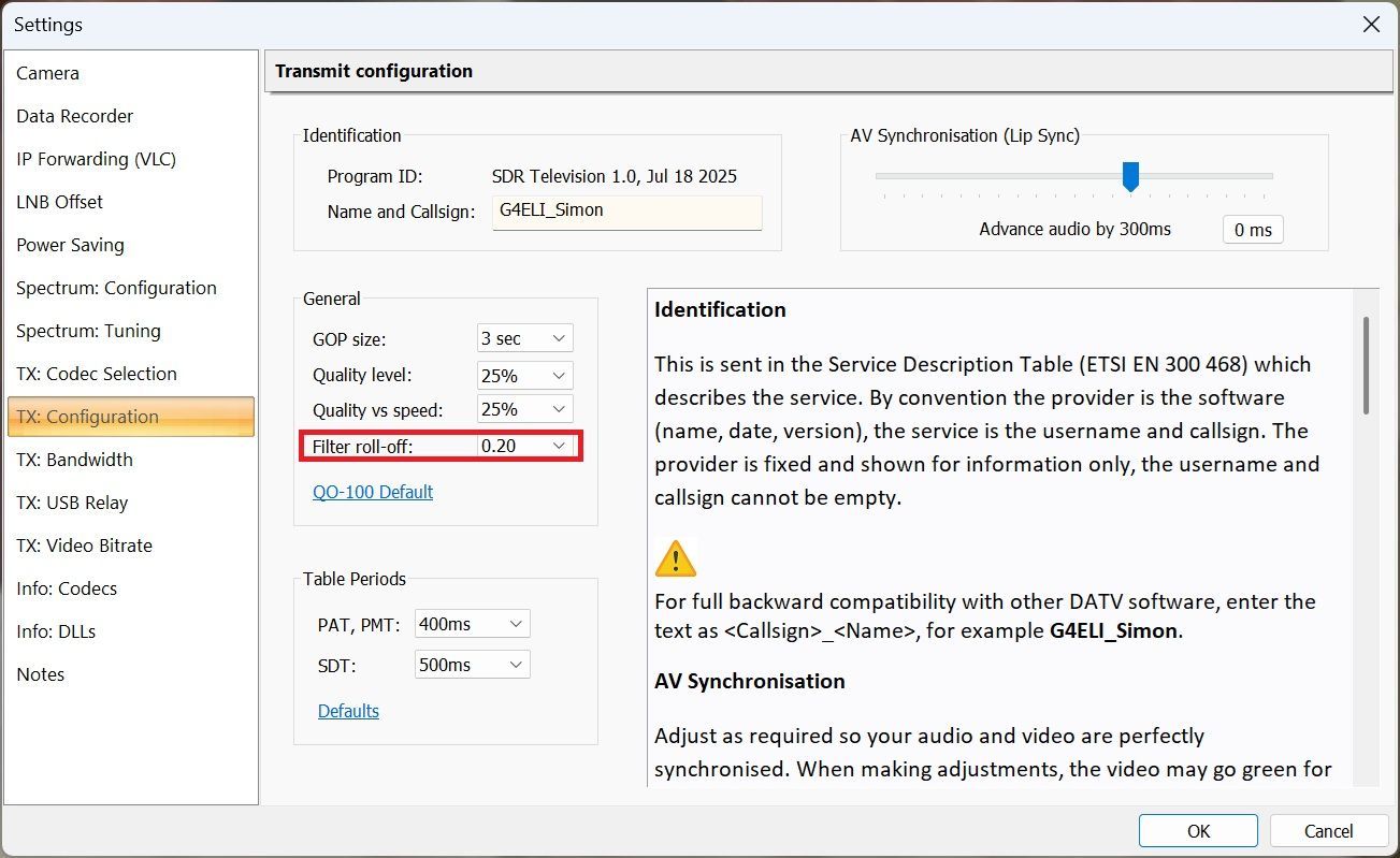

  • Changed the default transmit bandpass shaping filter roll-off to 0.20 in transmit and receive. Please look at the images below and apply the change.
