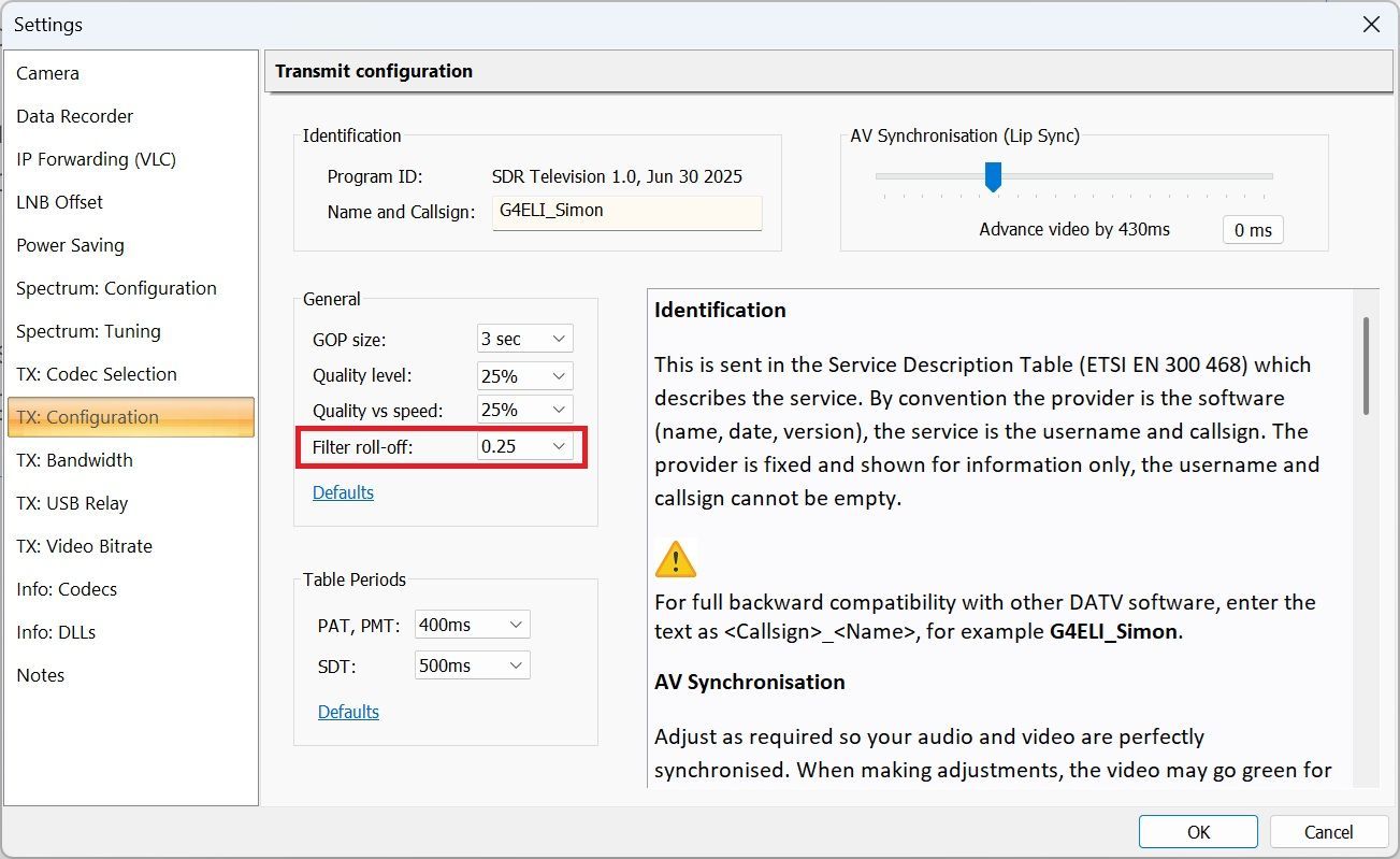

  • Changed the default transmit bandpass shaping filter roll-off to 0.25. Please look at the image below and apply the change.
