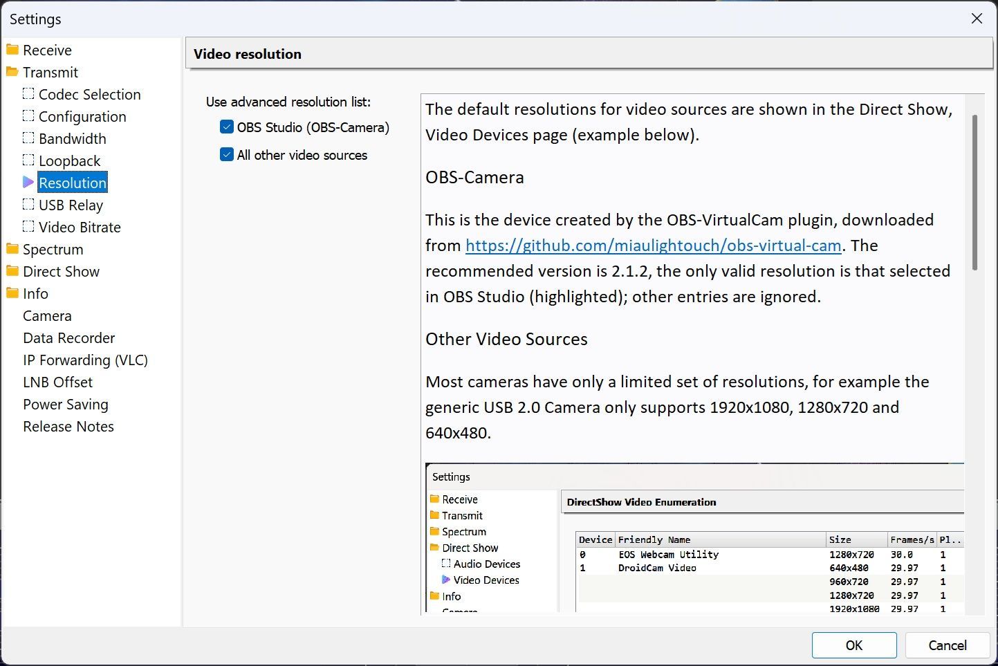

  • Better detection of OBS Studio running state; started or not started.
  • The selecting a video source the list is reloaded as the state of a source may have changed and become available.
  • Using Microsoft Video Resizer DSP (CLSID_CResizerDMO).
  • Optional: Extra resolutions added when using OBS-Camera (OBS Studio) and/or other video sources.
  • Tested 360 x 180 using 125 ksps, support for 66 ksps will be added in a future release.
  • Resolutions and frame rates are now sorted high to low in the Transmit, Video selection window.
