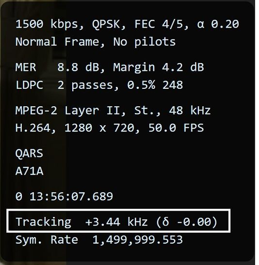

  • Updated frequency tracking by adding a rotator (NCO) after the SDR data decimation (NCO, Downconverter). This help with signal locking and possibly decoding of weak signals.
The Decoding Overlay now shows Tracking instead of Offset. The first value is the offset applied to the IQ data from the SDR, the second the current offset from the first value. The first value is updated when the second value is greater than 1/10,000 of the symbol rate.

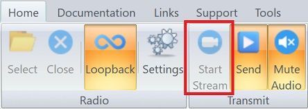

  • Start Stream cannot be deselected while sending.

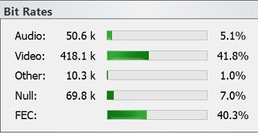

  • In the Receiver panel, Bit Rates all meta data packets (PAT, SDT etc.) are shown as Other.

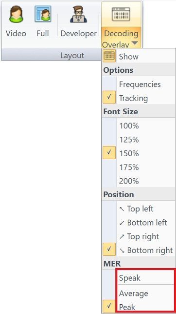

  • Dish Alignment features:
  • Optionally speak the MER value using Microsoft's text-to-speech.
  • Display either the average MER or (new) peak MER, peak being better for alignment.

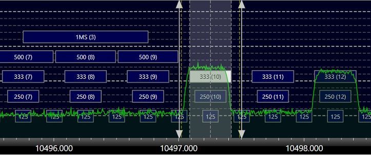

  • The current QO-100 channel selection is highlighted.
  • Added 175% and 200% to the Decoding Overlay, Font Sizes. Useful when using a laptop for dish adjustment, larger text size makes reading MER easier.

  • Added tuning bars in the spectrum, these show the frequency and symbol rate for the current mouse position.
