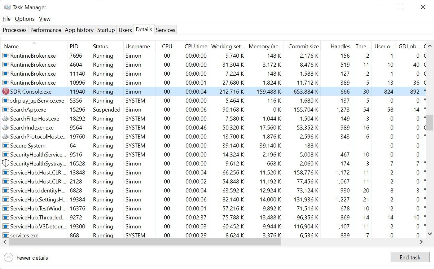

Monitoring
Use the Task Manager to monitor process size, handles and GDI objects. To select the columns shown in the display just right-click on the title bar (Name, PID, Status...), then click on Select Columns.
As you interact with SDR Console the Handle and GDI object count will increase but should now stay within this range:
  • Handles - maximum of 2,000
  • GDI object - maximum of 2,000 (in practice closer to 1,200).
